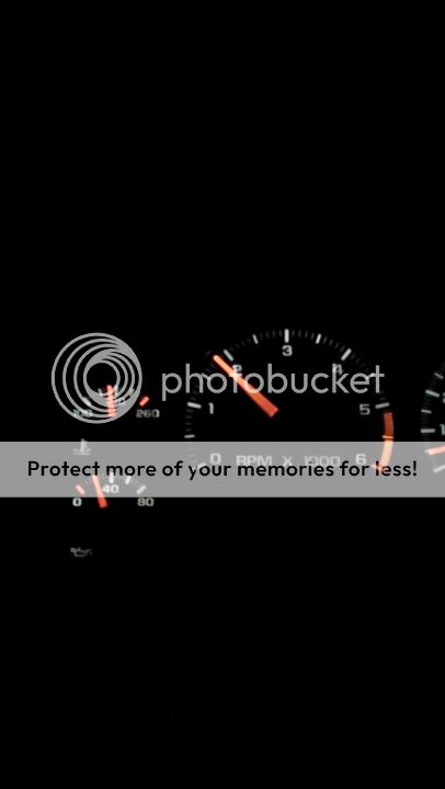

I got a video of my problem, well some of the problem.
this was probably 75% throttle. It does this every time in every gear (if I am really in the skinny pedal) otherwise it drives perfectly normal.

Notice how it slips right around 3K and then when it starts bouncing off the rev limiter I let off the throttle and it shifted...

Also, I put the transmission in 1, and it still did the same thing...
