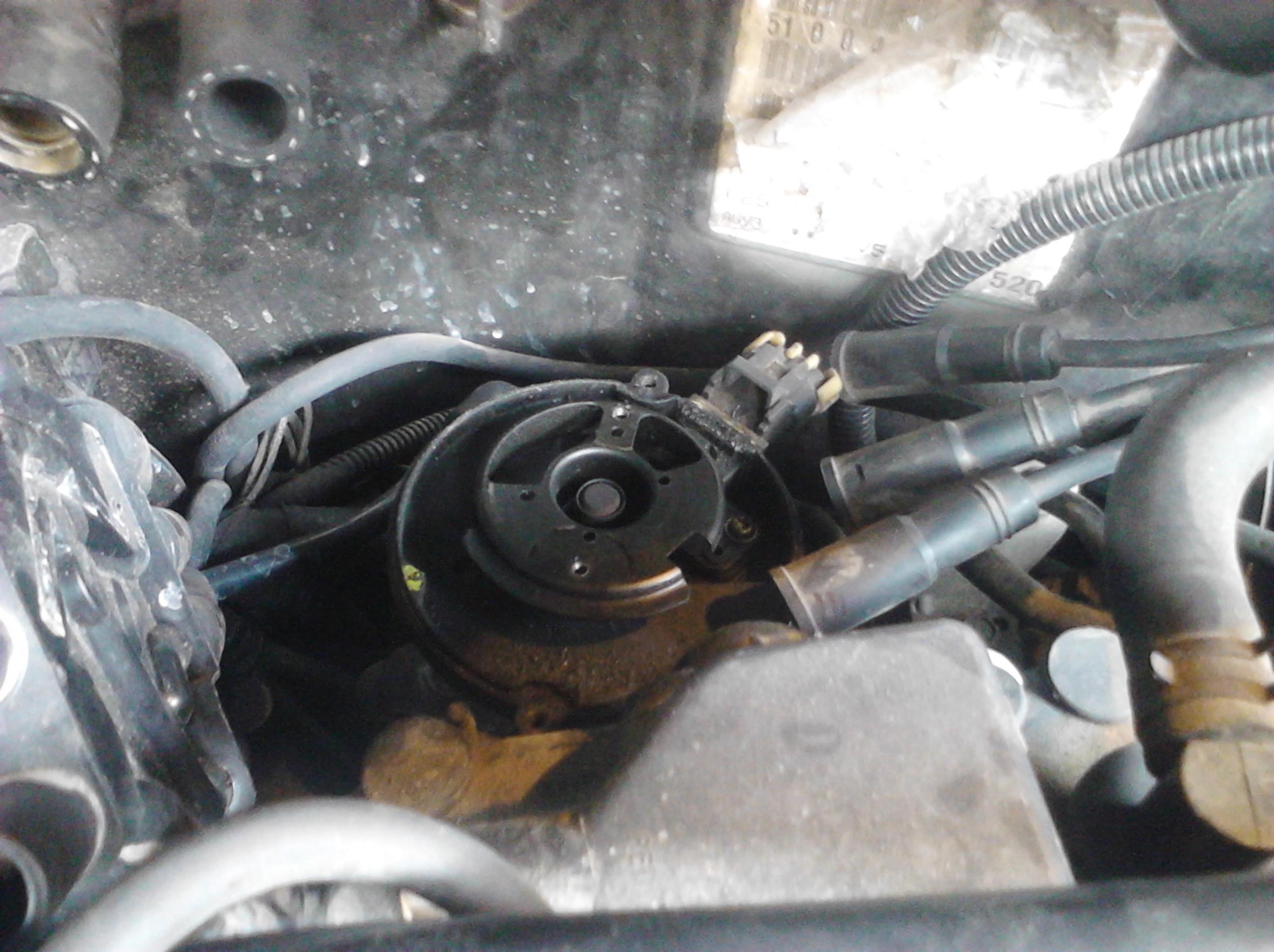

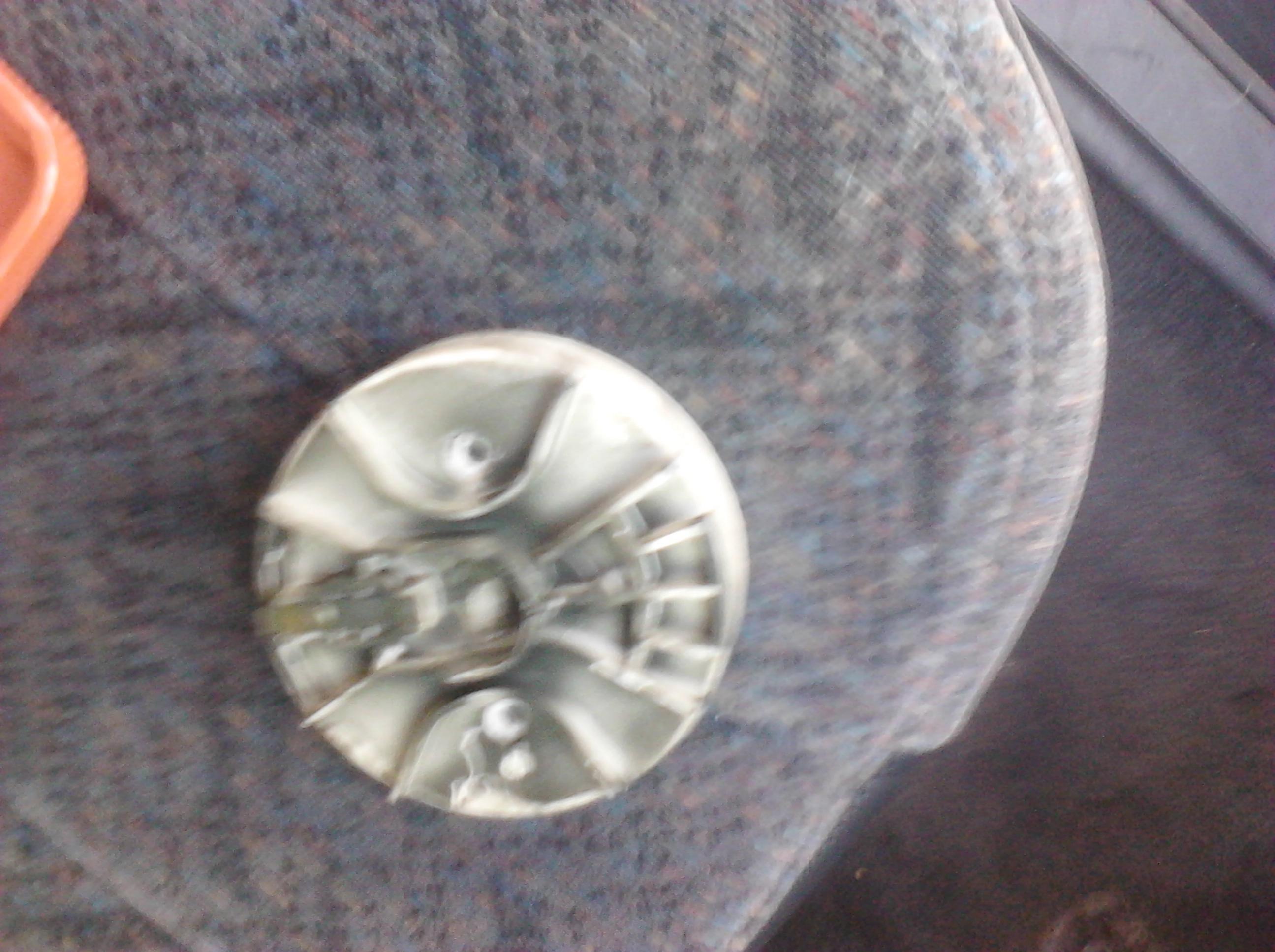

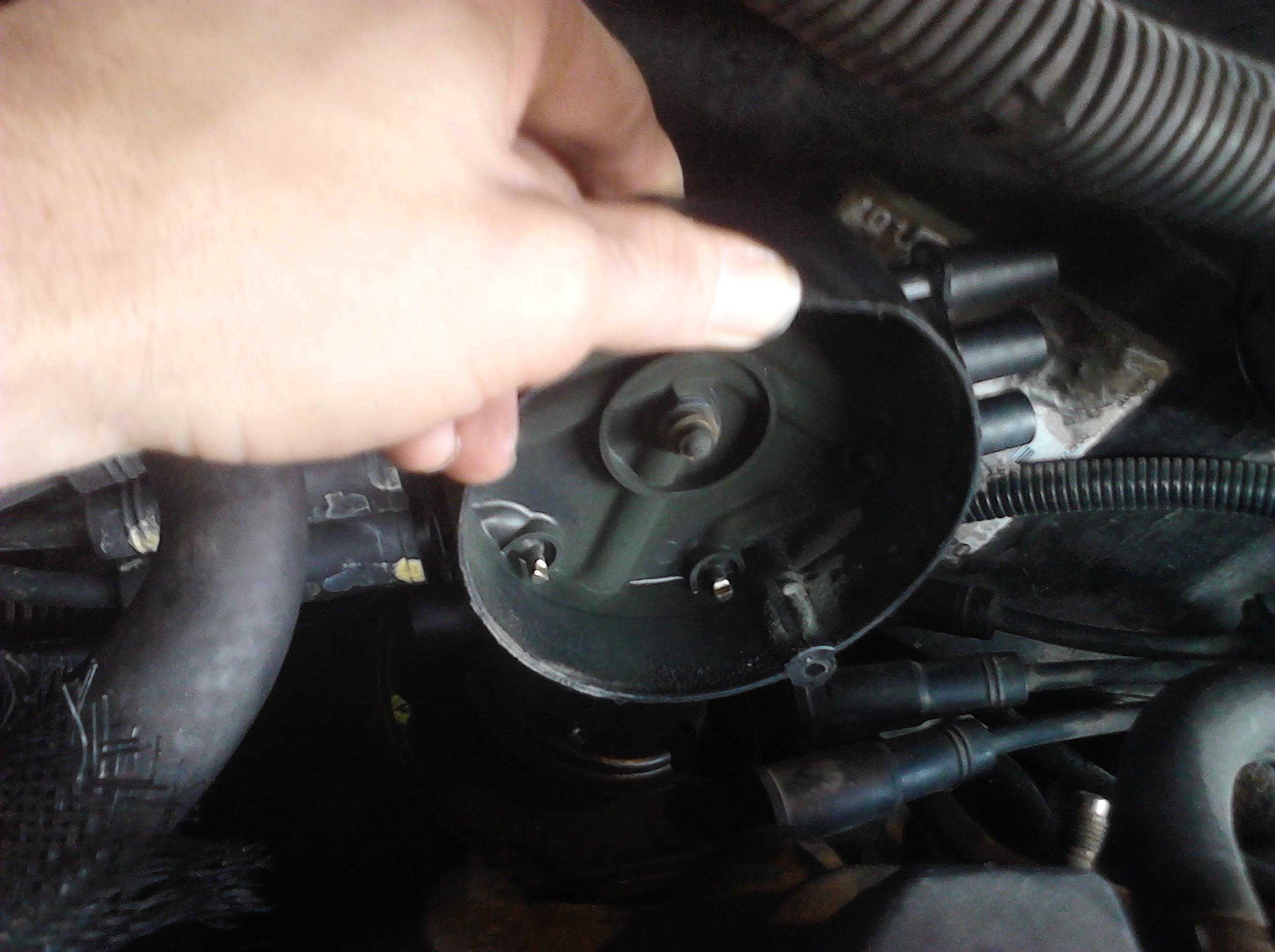

so I got antsy and looked at it a few minutes ago. first off someone put the wrong screw in the back and it was loose. second I don't know if it is normal, but I can pull the top of the shaft where the roter attaches forward about 1/4 of an inch, I doubt this is normal. any way, I couldn't find the right screw, but I got it tighter. it still clicks. Do I need a new dizzy, or should I try the new cap and roter w/ the proper screw. I don't want to just replace the cap, just to have it get screwed up again. how do you spell roter anyway?

if you can see it the contacts on the back of the cap are worn, but the play in the roter is toward the front, weird.

Yes sir you need a new distributor, the top bushing is worn out, hit a salvage yard and get one cheap if you dont have the coin to drop $100+ for a new one.
