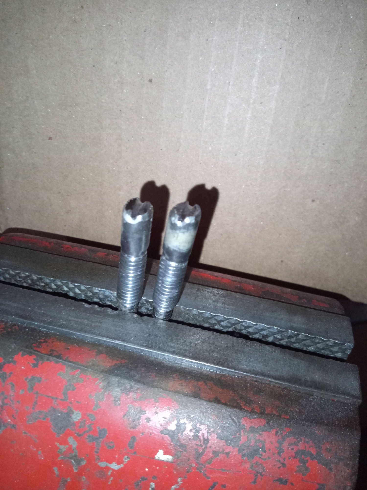

That's a good tip about the studs or guide pins. Guide pins allow the intake to be positioned correctly, so the sealant on the block does not get smeared.
If you buy new bolts for the intake manifold, guide pins can be made from the old ones. Cut the head off the bolt, give the edge a bit of a taper, and then cut a slot into the top of the pin so it can be removed with a screwdriver.
Guide pins.
