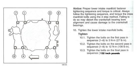

Need to move P/S bracket forward to get at front drivers side intake bolt. Don't need to remove it completely just slide it forward on the three studs. Note there is one additional fastener at exhaust manifold and another at very bottom of front of engine right above the pan. Total 5 nuts/bolts to remove in order to slide it forward.
Only use the Felpro gaskets for the lower intake.
Run a tap through all the intake bolt holes in the head (especially 4 blind holes on the ends) to insure they are completely clean and don't have any debris packed in them.
Wire brush all the junk off the intake bolt threads.
Apply white liquid Permatex sealer and torque in steps and in sequence to specification using an Inch Pound torque wrench. YES GET ONE! Go over them again in 24 hours.

ok, so i replaced the lower intake(MS98002T) and the injectors (ACDELCO 2173028). chased the bolt holes with the tap, all new bolts with thread sealer. torqued down to 132 inch pounds, not foot pounds. torqued them down in the pattern. got it all put back togeather and fired right up no problem, faster then i acctually expected it to. i figured id have to crank it a couple times. but nope, nearly instant fire. runs smooth, not going over temp, but now its smoking out the exhaust. it seems pretty white, but it doesnt seem to be losing coolant, atleast not noticeably. or burning oil. it seems like there is alot of water dripping out the tips so im assuming its burning coolant. any ideas whats up, do i have to pull it back apart and replace the gaskets again?
