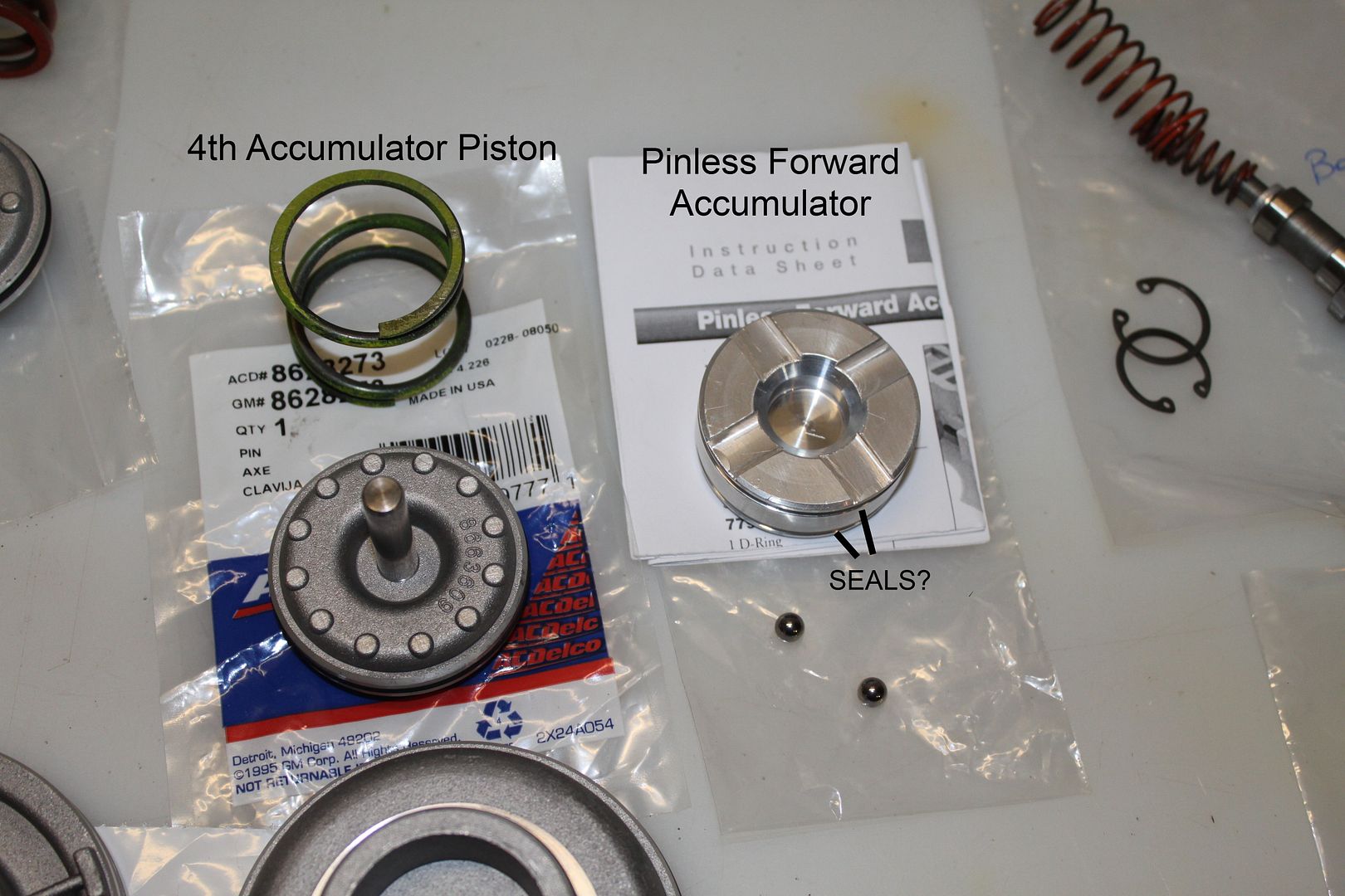

Both of the accumulators should have their more flat side (possibly with small round protrusions on it) facing the separator plate and neither should spring out past the end of their bores. I can't remember if the springs are different lengths or not, but if they are, check to see which is longer and put that into one of the locations and see how the piston fits. If it rests level with the mating surface, then that is the proper spring for that area.
Here's a shot of the pistons & springs that I installed in my Tahoe:
4th accumulator piston & pinless forward accumulator piston kit
1-2 accumulator piston & springs (depending on which housing type is installed in the trans)
For the 1-2 accumulator, my transmission had the Type 2 kit so I used the kit spring inside of the stock spring instead of replacing it with the three spring set. I only used the kit spring in the 4th accumulator piston.

But to the point, looking at my manual the piston goes in first. The side with the pocket accepts the spring. Both springs will push against the separator plate.
Somewhere I saw that if you flip the pistons over, it helps prevent them from wearing out in the pin bore(causes all sorts of problems). Don't quote me on that because I'm having a hard time sleeping.
