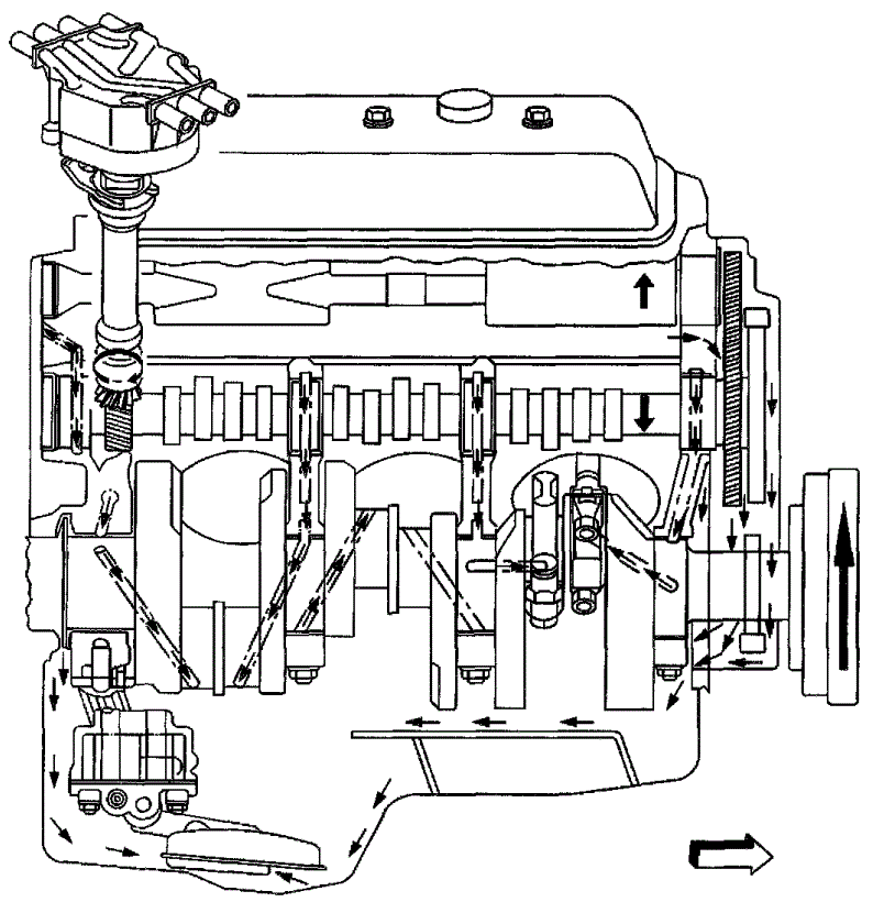

Here are a few images I was able to dig up. The first is for your engine specifically:

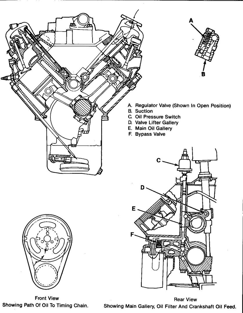

The second is a rear shot showing the oil galleys for an '89 TBI motor:
The biggest difference is that the 92 CPI motor has a balance shaft and the motor depicted does not. This changes the oil passage locations a bit, but not too much. It will give you an idea of how you can read oil pressure and still have lifters tapping. As you can see, the oil pressure gauge port comes straight off of the main oil feed galley to the crank without any other interruptions. If there were a restriction in the oil feed up to the cam bearings or into the galley supporting the lifters, it could definitely starve the top end of the motor.
