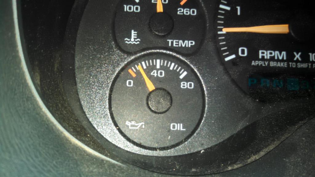

and when I mean really low, I mean really low. [IMG][/IMG]
and the No oil pressure picture. [IMG][/IMG]

@idle it only requires 8psi....however u need to put a mechanical oil pressure gauge on it to see where it really is at!!! On the other hand if it was ticking away that isn't a good sign and indicates u have a severe problem on your hands...

I would do an oil change and check to see what comes out of it. My issue was on a Bronco but it started getting really low oil pressure. I did everything to see what it was, even had someone replace the oil pump. Problem persisted till i pulled the oil pan and found the pick up tube clogged. That was my issue.

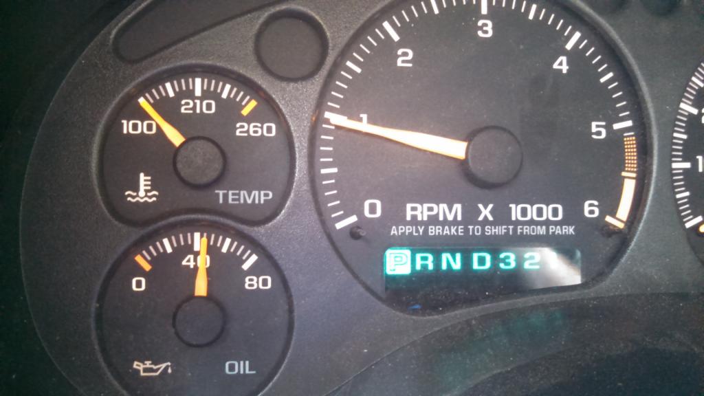

I started it today to see about the oil pressure, this is what it was when cold. (keep in mind it's about 95 when i started it) [IMG][/IMG]
And when it was warmed up, with the air on. [IMG][/IMG]
I don't get why it had really low Oil Pressure yesterday. I'm thinking it was just a bug in the pressure sensor.

its hard to say. when hot,tolerances change,thus lower pressures.
Could be a bad oil pump (unlikely) ,bad bearings or bad sensor. What weight oil are you running? thing should use like5 or 10w30 right now. you could try adding some 20w50 etc to see if it helps,but...we cant tell ya whats wrong. too many variables.

go to autozone or cadian tire, rent the pressure gauge test, remove sensor and check the reading when hot, dont forget engine RPMs will give you different readings, at idle 600-800 rpms the oil pressure reading when hot should be around 20 psi, least any jimmys ive worked on(work in a gm dealership) there usally around 20 psi, the ones who ahd **** maintance are like 15 psi.... but besides that i cant see the truck just randomly droping oil pressure unless the pressure releaf valve is sticking which is possable but unlikly, dont switch toa heavier oil until you test base oil pressure when its acting up... your wasting money.
never spend money without evidence on the issue, plain and simple!
