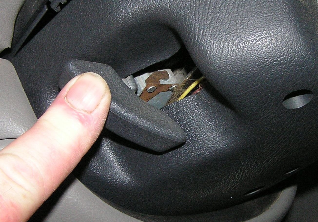

If I understand you correctly, those are the screws I removed from the lower cover.
And nothing holds the handle on but friction?
I am afraid to try that
Can a bunch of you all confirm this before I destroy my lever?
Thanks
I'm wondering if you are talking about the same lever as I am...
Is it this one?

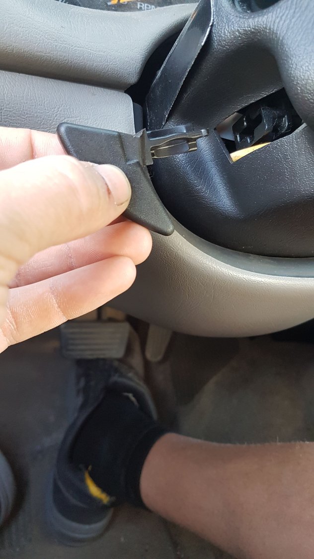

Default Pulled out

Thank you for all that effort !!!
My **** is different.
It has metal bar going into the rest of things. There must be a way to release it but I can't figure it out yet.
It really looks like I could break things.
Haven't had time to get photos of my situation yet....planting before the rain coming tonight.
I'm beat. Maybe tomorrow.
I am kinda doubting the switch is to blame .... but who knows.
Thanks again !

Np... I try to help when I can lol.
Maybe post a pic of yours, might be able to figure it out.

Thanks.
I finally took some photos. That lever handle, and some general engine stuff to give an idea of the condition of things.
unless wires go south under the corrugated wrappers with no exterior damage showing I find it hard to believe the wires in there are the issue.
Every connector I inspected looked fine.
