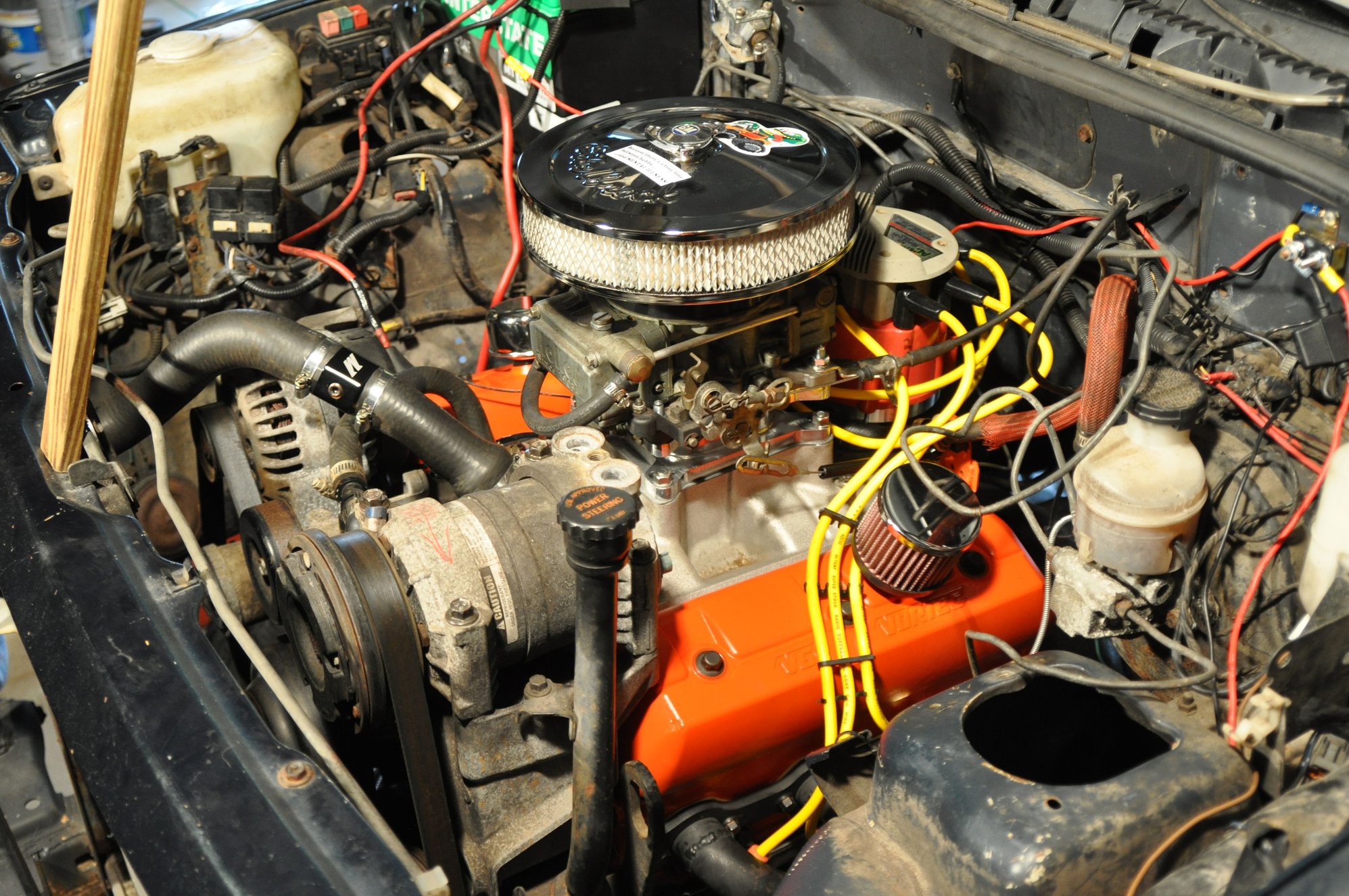

OK all::
The mini monster is done.......or so I thought it was done! I'm left with a headache and for now, my hands are tied. I took back the original starter that I got with my SUV/morph and have since taken back two new REMAN's and got a HD CARQUEST starter Part # 6449SN CQSNA and two new starter bolts for my 4.3 Vortec and I have the same whinny grinding skipping noises as I did with the other new starters. I've never had a problem such as this in my entire life restoring and fixing cars of all brands!!!
I asked for a HD starter for my '1998 Chevy Blazer' << Because I don't want to stand there and explain that I need a starter for my 1998 4.3 that sits in the frame of a 1992 Toyota 4 X 4 with a 1993 body of a Suzuki Sidekick sitting on top...... I use the Chevy Blazer because the ID numbers I got off the block >>14099090M<< tell me it's a 1996-1998 block, as all three years were the same block. I assume the starter would also be identical for all three blocks.
I recently pulled the heads ( 113) off and sent them in to be tanked and rebuilt by my buddy that owns an engine building machine shop. I found the magic ENGINE ID code they all say to look for stamped on the passenger side of the block just forward of the head that reads>> W5N15UFB << I'm certain it's a B and maybe not an R. This tells me I have the 'W' engine but I can decipher no more. I'm sure it's the key to the engine's identity but I find no record of that code. I've also heard that there is a code on the drivers side behind the head on a ledge of the block. I scraped and cleaned it off and it's 100% blank!
Anyway, I've been through a ton of videos and how too's and I find that I am suppose to take an 1/8 drill bit or allen wrench and get that gap between the starter shaft and flywheel and if too tight, shim it till you do get 1/8"...... We'll today I find that I have a 3/8" gap! I bought 'kitty corner' shims just in case but there's no shimming that. I would need to either find a starter with a larger spindle gear or mill 1/4" off the mount and I don't want to mill because I think my engine info may be back. I don't know. Maybe I have a Marine block,but, they are all the same. Right?
Anyway, I find that my 11 tooth starter gear is only engaging about 1/8 " of the ring gear teeth. I hear others talk about a 9 tooth gear also. Is there a larger gear I can have installed? Is my engine info correct that I am giving the folks at Advanced Auto Parts to receive this starter that I'm having problems with? Is there a solution to this problem without having my starter milled?? I hear bad things in the 1 to 5 star reviews on these starters. It is one day old with minor turning and I am now done until I can correct this.
BTW, I've done some tests and counted 168 teeth on my flex plate and find that it's 100% flat and not warped one bit. It's a 14" flex plate. And all teeth are accounted for and are NOT warn off in the least. The other starters have taken a mild beating though.... And when I get it started the engine runs like a charm!
Thanks all for your help and please post links that may help fix my dilemma....
