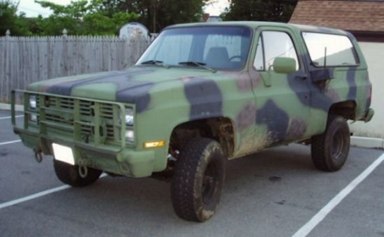

I wonder why it was parked in the first place. The 6.2 are know to have some major issues and could be the reason.
Before you jump into that truck do some research on the 6.2 diesel.
Having said that, I had an old 1984 CUCV with the 6.2 years ago and i loved it but i had one of the good ones and it was still gutless being a non turbo engine.
Also i only paid $3000 for this blazer but that was in 2007.
