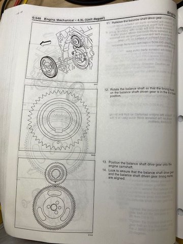

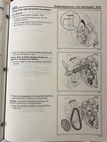

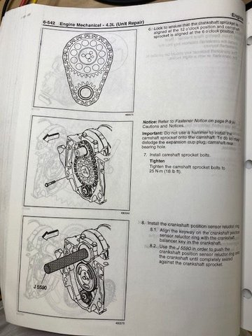

You do your final distr position set with Cam Retard after you either elongate the hold down clamp flange or replace it.
Gears, chains and sprockets:

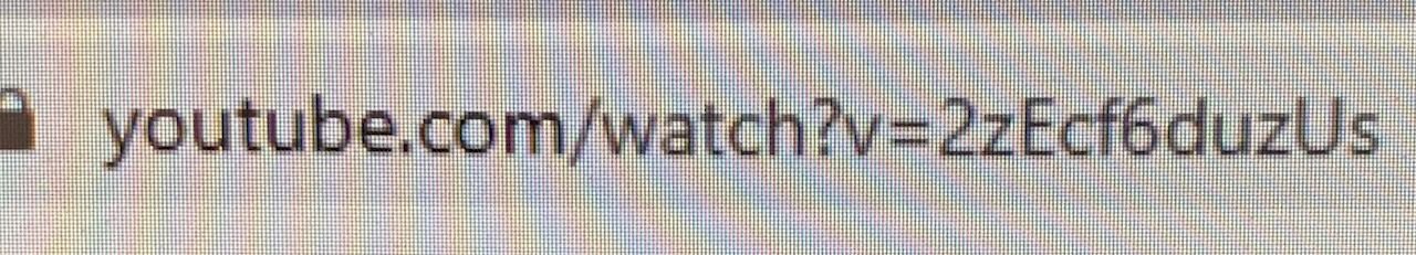

Video link address:
