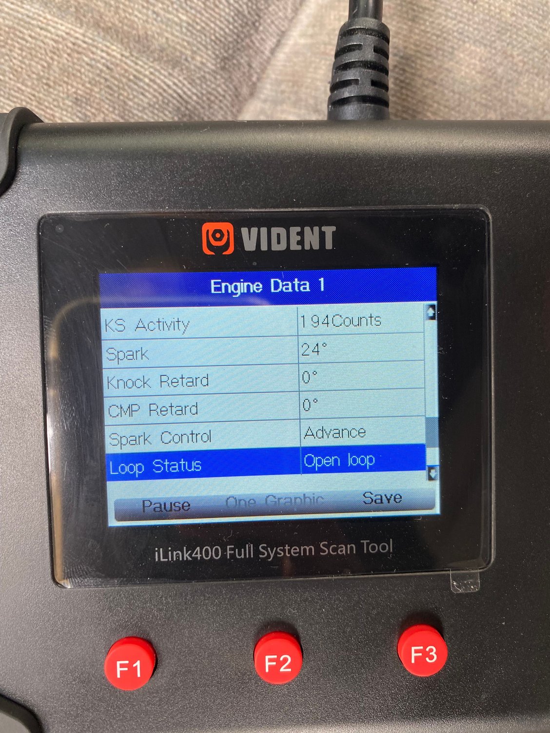

Here is what I have found:
Cylinder 4 had the least amount of change in idle when disabled.
Cam sensor retard below:

Cam sensor retard of 0° is right on the spec. But am curious why system is not in closed loop (you just happened to show this). Let's focus on that for a minute. Engine is running, correct? Not sure what cam sensor will read with KeyOnEngineOff.
If engine was running when you took the photo, double check the loop status with engine fully warmed up and running for a while - and if still open loop let's figure out why it isn't going into closed loop. This could be a key indicator for your performance issues since open loop only uses default settings programmed into the PCM at the factory and not any actual feedback from sensors. Also open loop could be mandated by the system not being able to meet some criterium required for allowing closed loop (like a failed sensor or circuit).
You do realize that this scanner is monitoring these parameters in real time? Just want to make sure you understand the difference between reading trouble codes stored in the PCM and reading real time PIDs (OBD2 Diagnostic Parameter IDs). The cylinder balance test utilizes what is known as bidirectional control (yet another mode).
As for the weak cylinder, I am asking for amount of rpm drop at both idle and at 2000 rpm when each injector is disabled. I am asking you to make two tables of data. And best if you can repeat by doing a second time.
Is the SES light working when you first turn the key on and then goes out when engine is started? Need to make sure this is the case.
So please report if engine was running or not when image was taken, and make the tables please. If engine was not running before, then also advise cam sensor retard with engine running. Also please answer question about SES light.
If engine was running when image was taken, and still is not going into closed loop when fully warmed up - then we will focus specifically on getting into closed loop in hopes this will lead us directly to the performance problem.
As an aside, for the KS counts - IIRC you said your 1998 has a 2001 engine in it. The knock sensor mounting is different between those years. We may need to see what the PO has done before we are finished (remember the EGR tube) but not a concern at the moment. What about the A.I.R. pump and associated tubing and valves going into the front of the exhaust manifolds. If that's not intact then that could possibly have something to do with the open loop since that quickly heats the O2 sensors when first starting. But eventually I would think that the system would go into closed loop, even without it working at all. Emissions readiness monitor would never pass but closed loop should still be attained eventually.

Yes, the vehicle was running but it wasn't up to temp. Checked again when it was at operating temp. Data below:
Looks like it is going into closed loop, must've just not been to operating temp first time around.
