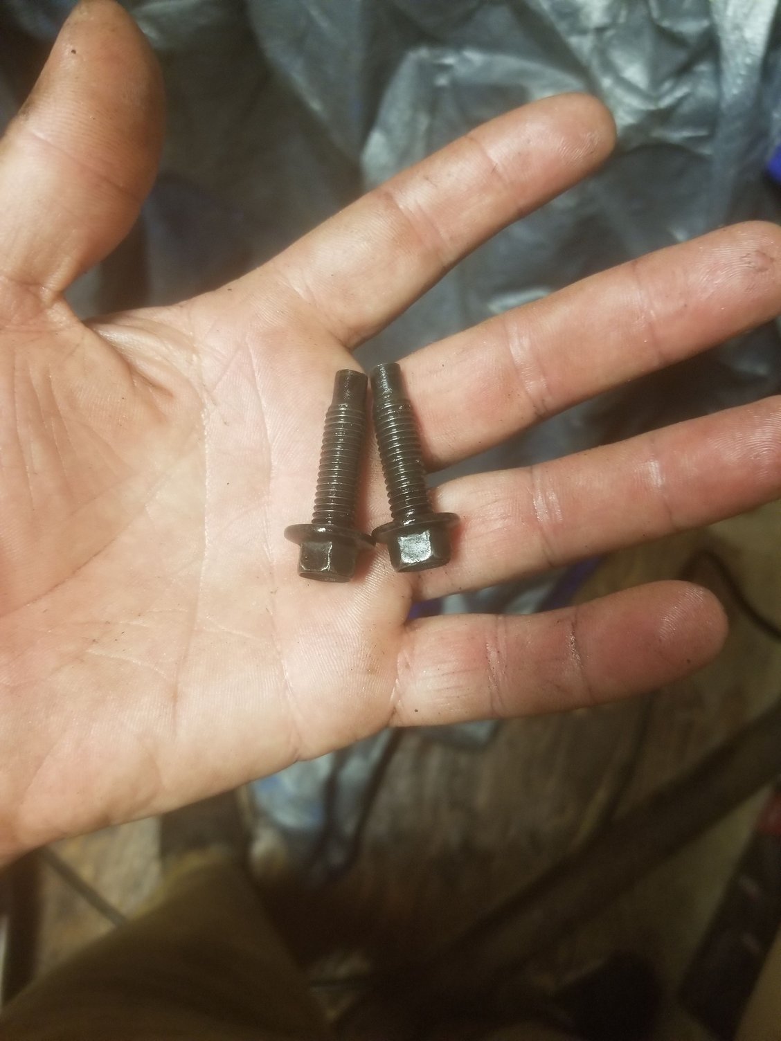

Yup. Input spragg was backwards. Just got it put back together. Bad thing is I lost two pan bolts and gained two other bolts. Cannot remember where they go. 10mm heads.

Those 2 bolts hold the bracket for the shifter cable that bolts to the pan rail. That bracket doesn’t use regular pan bolts. You need the longer length bolts on that bracket for the force that is applied to it from cable.

Well I guess that explains why I'm missing two pan bolts lol

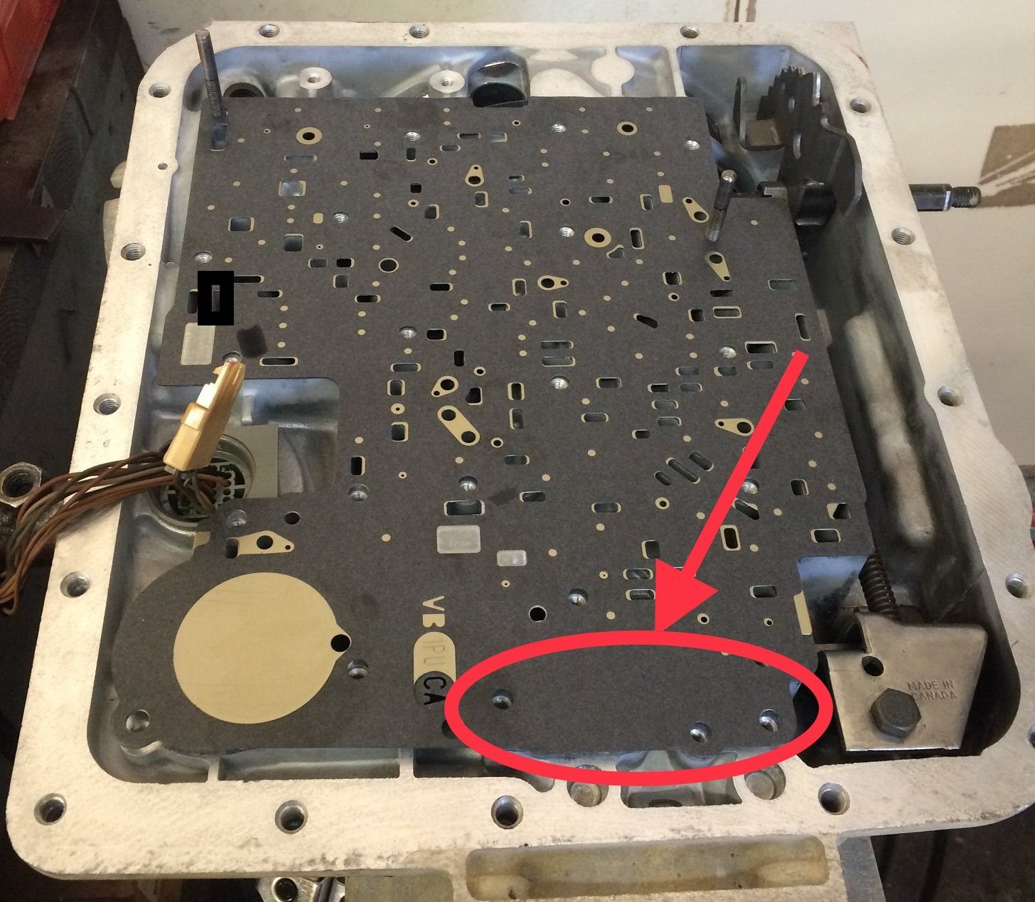

So I got it all put back together. I have drive, but no reverse, 2nd gear, I think 3rd gear wiggled. Neutral moves the tires forward. I'm thinking maybe where the shift cable attaches to the prnd1 switch. But if it was out of sync, park would be off too, right?
Old May 12, 2020 | 09:31 AM
Transman304's Avatar
Joined: Aug 2016
Posts: 505
From: West Virginia
Transman304 is on a distinguished road
Try starting it in neutral also, that’s a quick indication if switch or cable is out of adjustment. By chance did you remove the valve body on the second time in? Common no reverse after overhaul is not getting the 3 8mm head bolts on the rear of the separator plate tight.
