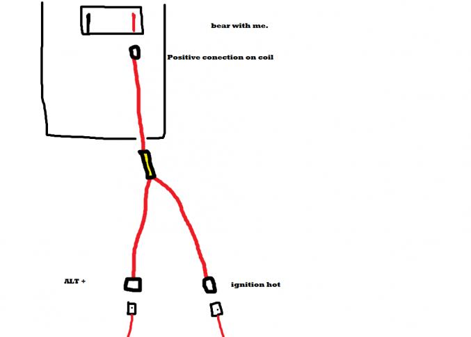

Alright, I went to go start it again. after messing with some wires. and the same old thing is happening. I tried another ground, I tried another source of 12+ volts. Nothing. BUT here's the thing, the old problem came back. Where it would get spark for a second after they key was turned off (after of course it refused to start). The fan would also spin in the opposite direction. Here's a video of the problem, and the battery is on a trickle charge at the moment and will be all day. I haven't charged it in a long time, but I know that's not the problem.
and oisinirish: I have done what you said and I made a home-made connection to the coil. brand new wires, cutting off about 6 inches on each wire to get clean copper wire. (attached is my home made connection)
