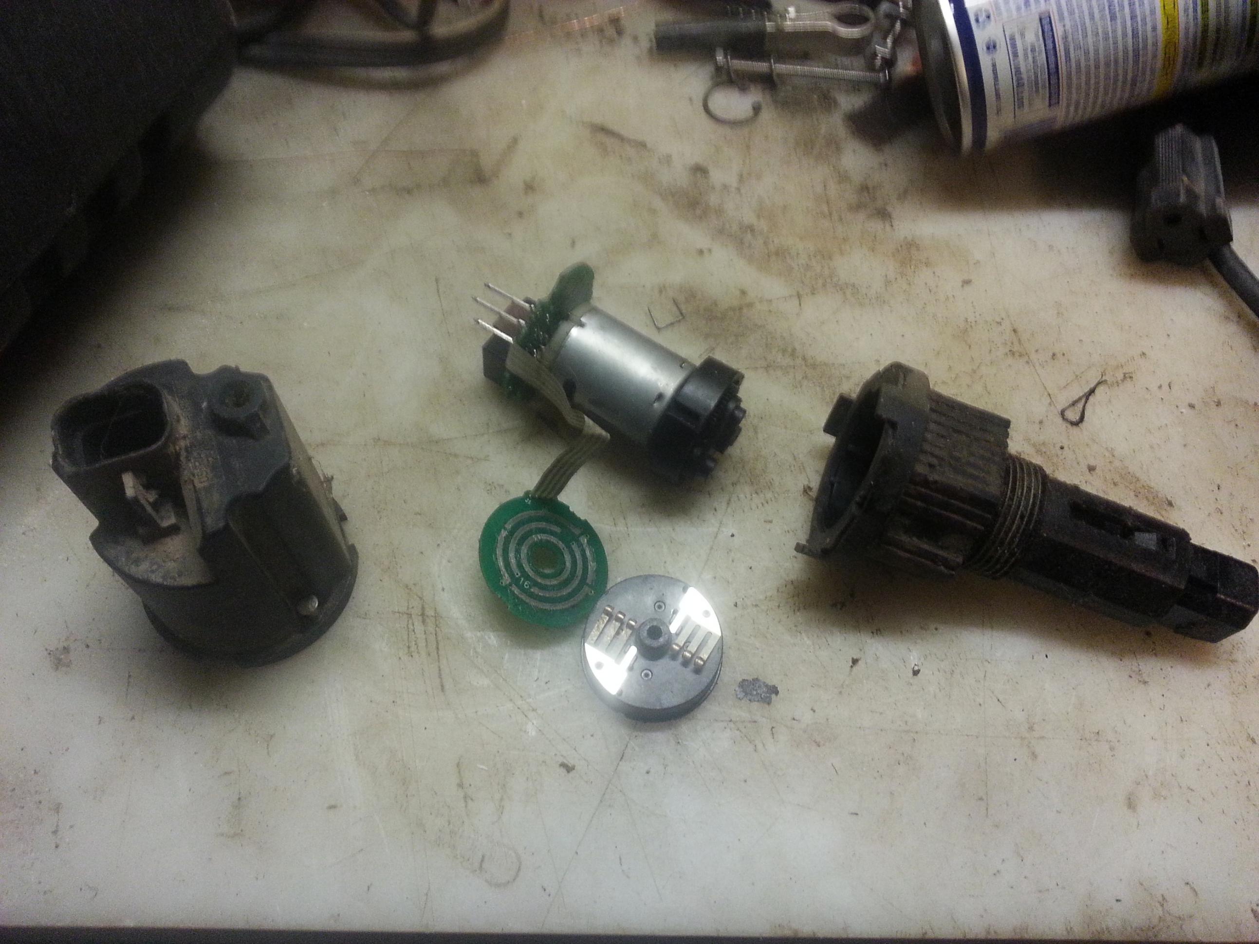

Anyway, when I was down at my dads house today, I saw an old stepper motor front axle actuator sitting on the shelf. It was cracked and water had gotten inside it shorting things out. Dad beats the crap out of his trucks! Anyway, I grabbed it and will snap some pictures of the plug and the whole unit for anyone interested to have a look at.
*EDIT* - Here's the guts of the upgraded stepper motor actuator for the IFS fullsize trucks:

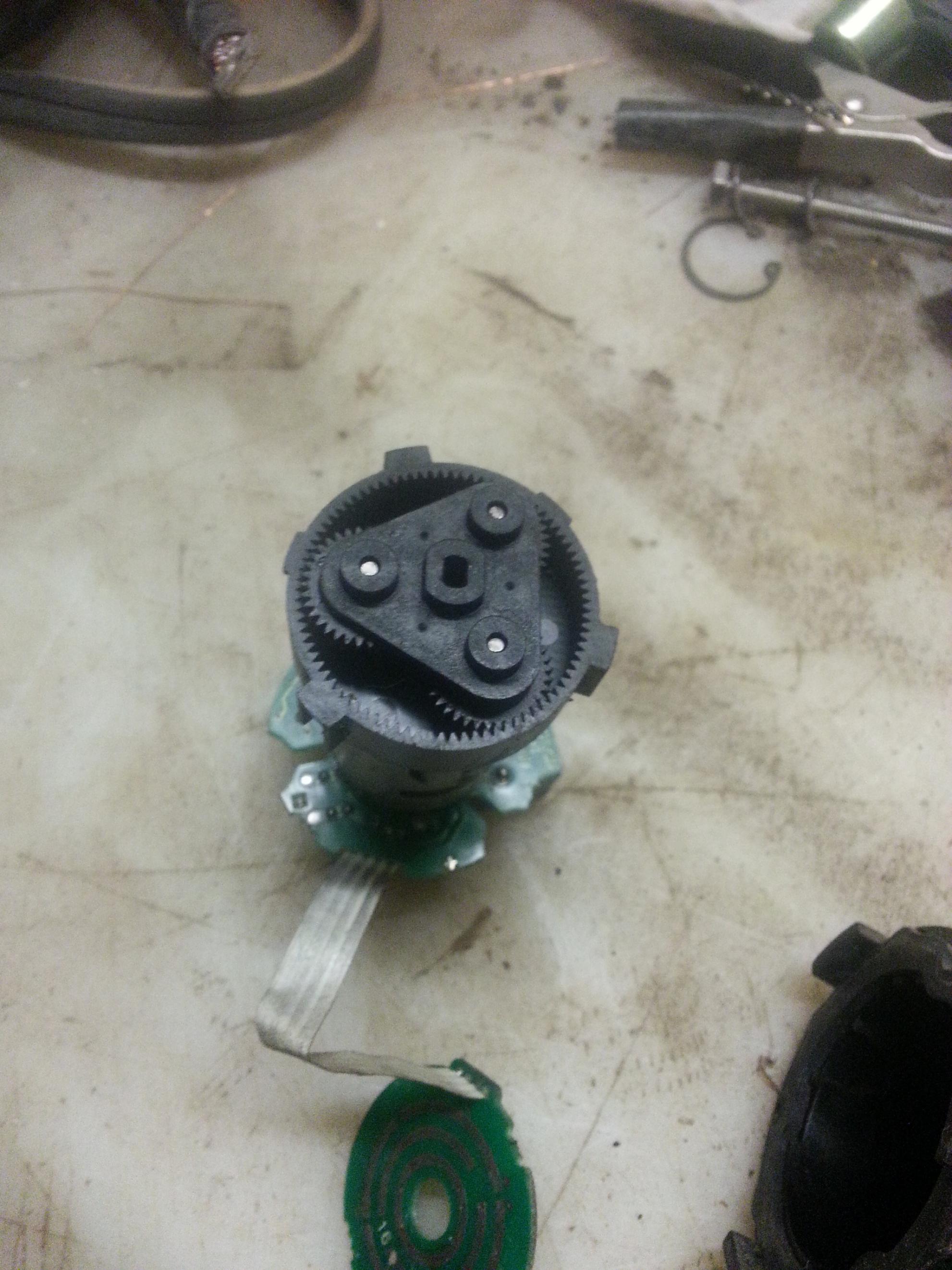

It has a gear reduction drive between the stepper motor & the threaded rod that drives the piston out to engaged the front axle so it's stronger than all heck (provided the threads on the threaded rod don't strip):

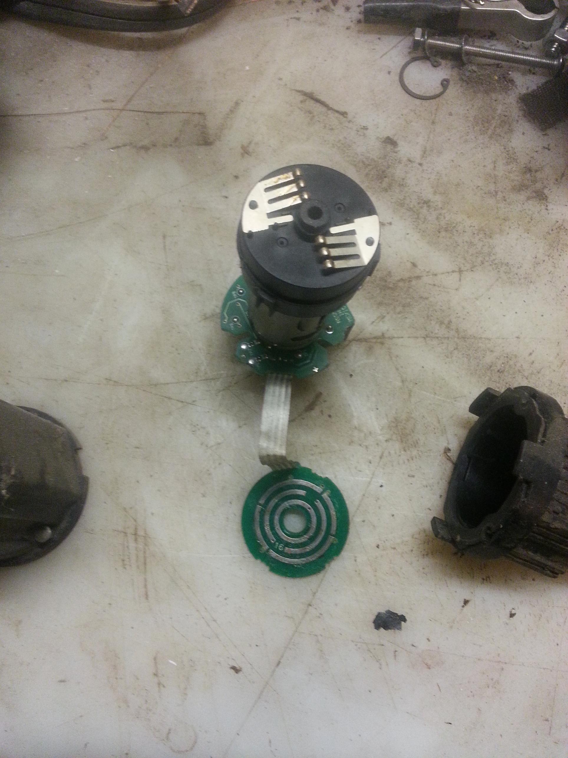

It incorporates an encoder to keep track of the number of rotations of the output shaft:

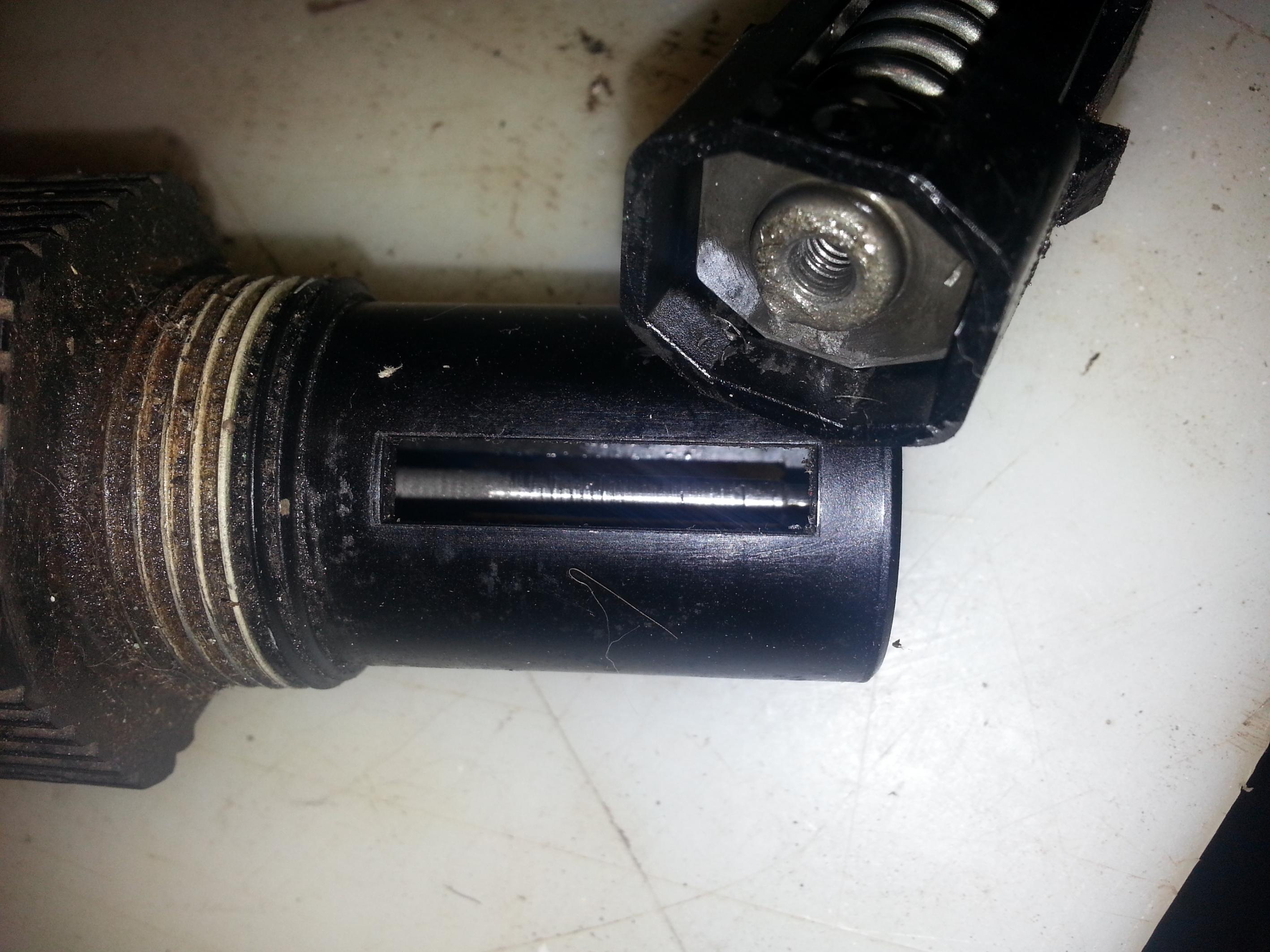

I mention the threads stripping because that is what finally did in the actuator I disassembled as you can see in the picture below:
This is the weakest point of this actuator, but it is far and away a more reliable design than the thermal or electro-magnetic design which predated it.
