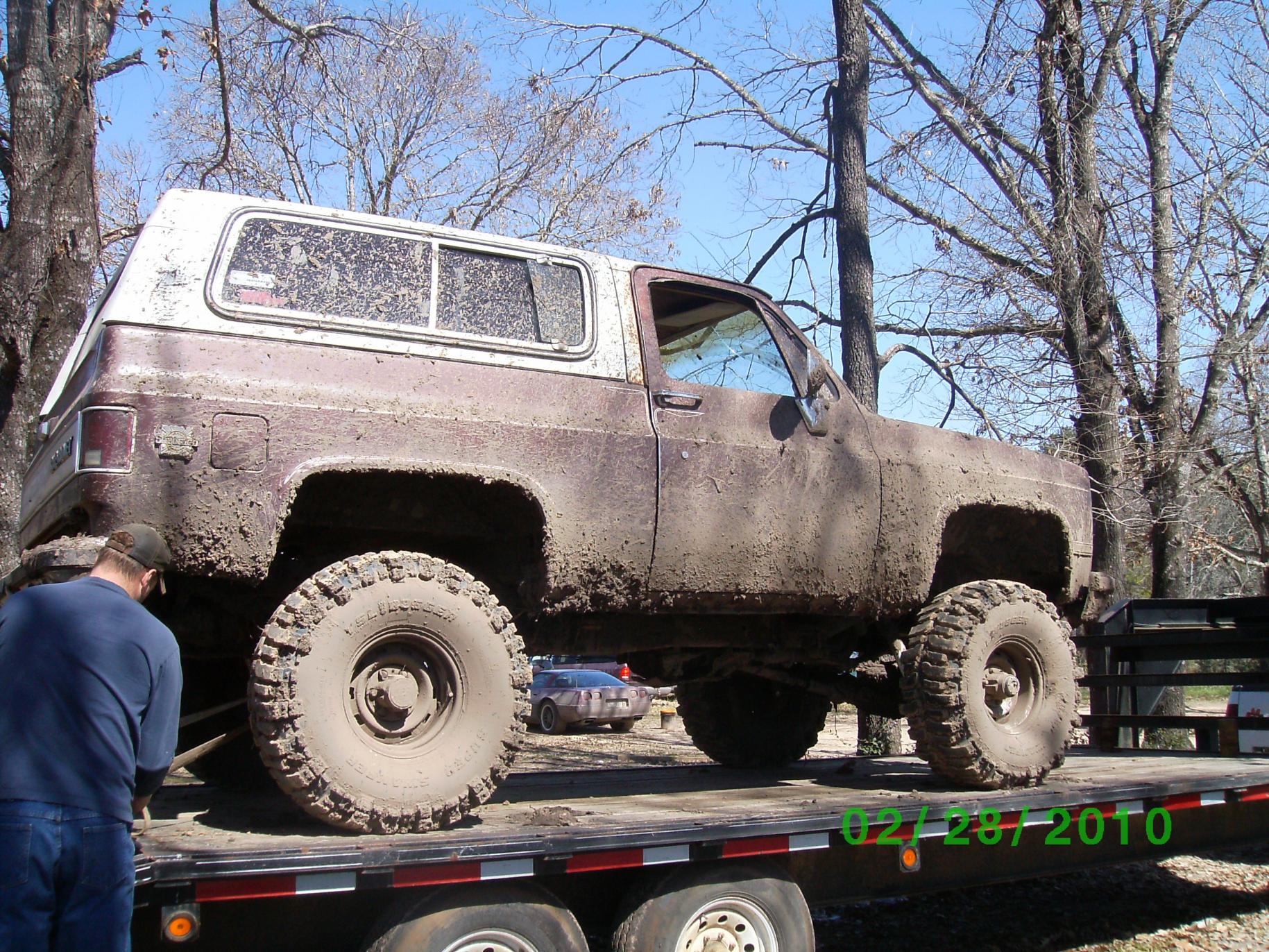

Wheel speed is one of the reasons I was thinking lower gears. In a mud bog it starts off as a drag. Getting 3.08 gears turning even with a 454 takes a little time especially with a stock 1500 stall speed converter. After I get my tranny and new converter back and try it out I'll see if it need gears or not. Hopefully this weekend. With the cam i'm running the engine really dont come alive till around 3000 rpms. Over that and the torque has no problems spinning the 37's
before and after
