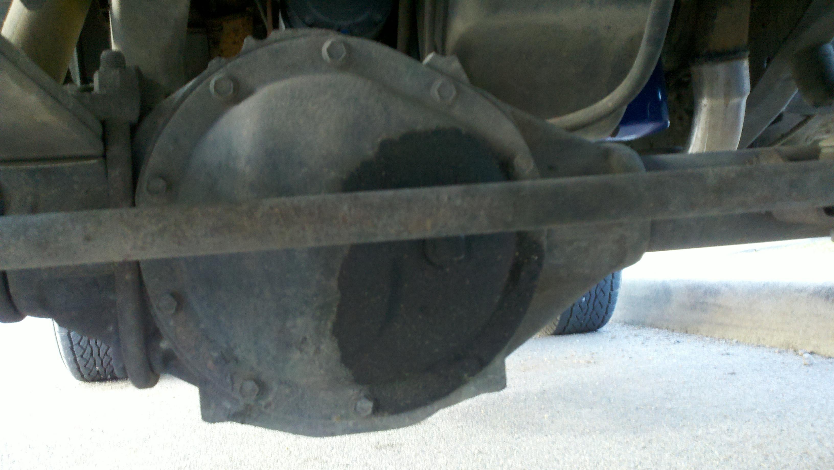

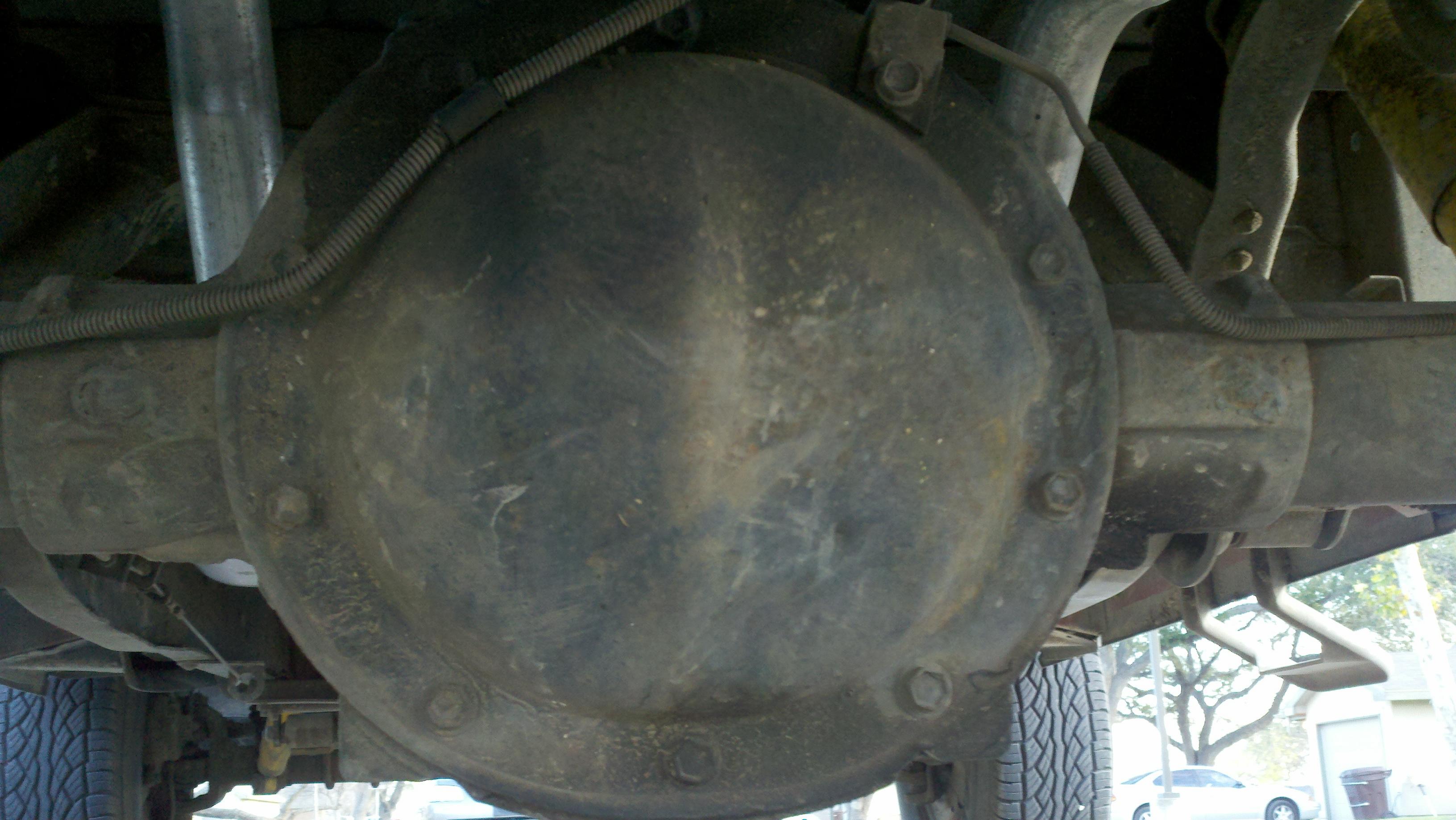

I have included a picture of my axle housing. The first picture is the front axle housing and the second picture is the rear axle housing. Was wondering if someone can tell me which type of axle I have.

front is a dana 44 and rear looks like a corporate 10 bolt. there should be a code or sumthing on ur axles that u could google to find out what they are too. but im pretty sure im rite.

Front looks like a GM Corp 10-bolt to me as does the back. Definitely doesn't look like a Dana 44 up front. A shot of the outer knuckles would confirm that, but I'm pretty sure it's a 10-bolt.
*EDIT* - I took a look in my photobucket account and found the picture of the donor Corp 10-bolt and then went out and snapped a picture of the Dana 44 in the front of my '74.
Here's a picture of the Corp 10-bolt I bought for $30 to get the 8-lug outers, brakes, etc to swap to my Dana 44 when I put my 14BFF in the back:
And here's a picture of the Dana 44 in the front end of my '74:
Notice the lack of little ears off the bottom side of the center section & the deeper plug weld holes on the front of the center section on the Dana 44. Also note the shape of the diff cover. The Dana 44 is a narrower cover than what is used on the Corp 10-bolt.
You have a Corp 10-bolt front axle.

if u look at the pic of the rear u can see the knuckles of the front axle showing its a dana.
