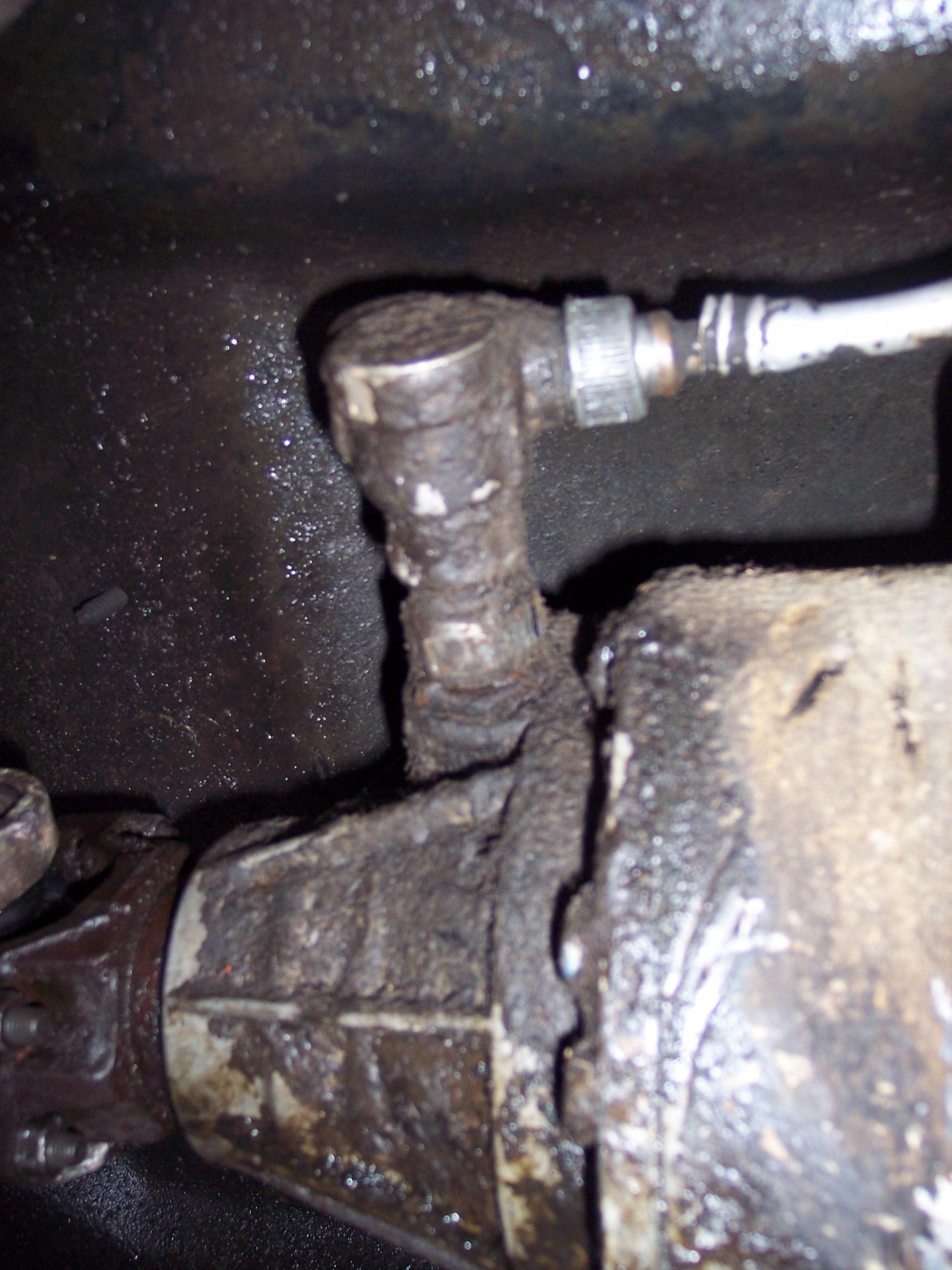

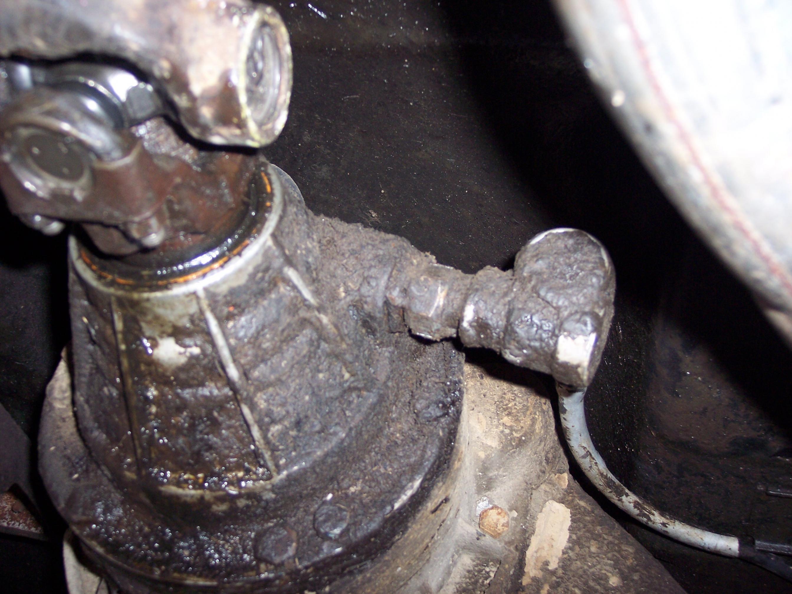

Here are the two pictures.

Ok, that is close to the same setup as mine. the cover is just rotated 180* and there is a right angle drive on it.
I would disconnect the speedometer cable (what points towards the front of the truck). Then remove the right angle drive. Make sure that the right angle drive is working. With the right angle drive out, remove the bushing which retains the drive gear (what I show in my pictures above). Look in through the hole in the side of the output housing for the plastic drive gear inside.
You can test the speedometer in the gauge cluster by attaching a variable speed drill to the cable you disconnected from the right angle drive. With someone watching the gauge inside, slowly speed up the drill. If the gauge does not work, then the problem is in the gauge.
