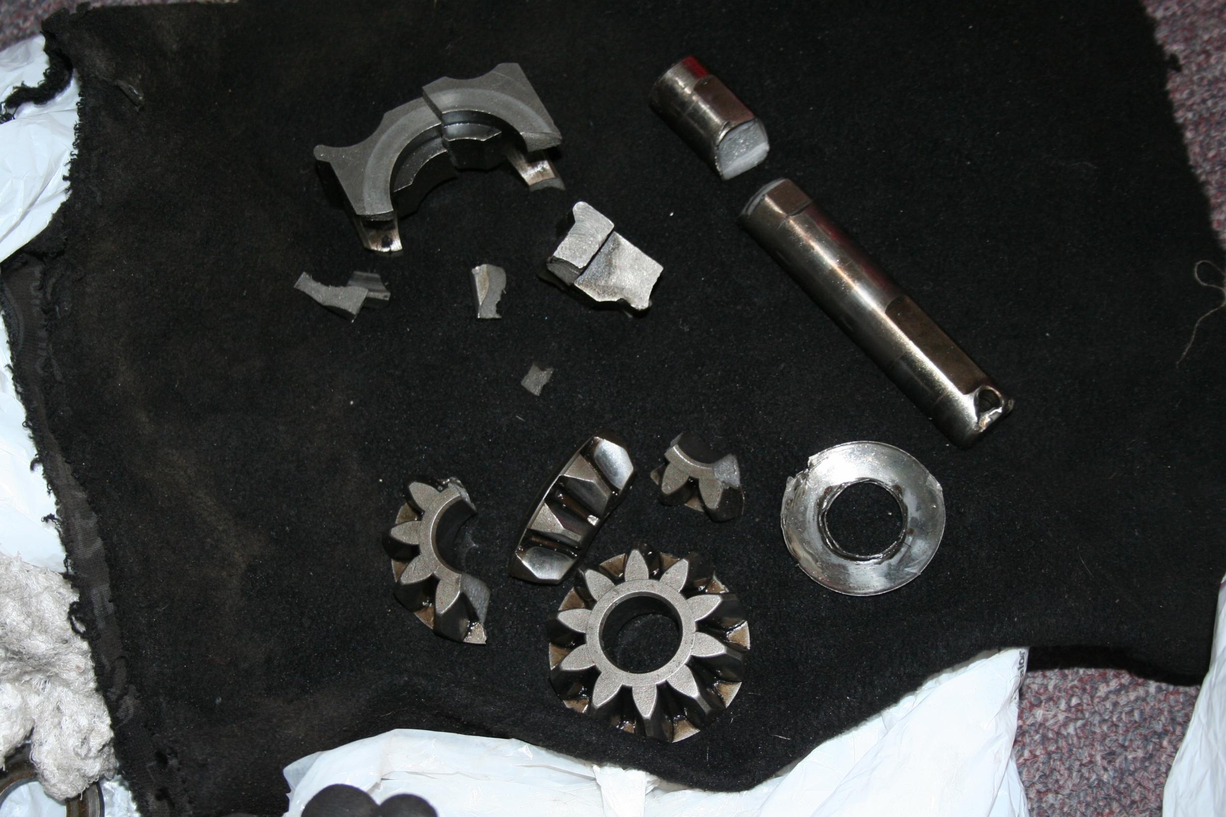

Hi friends, afther enjoy my new tranny for about a month, yesterday I broke my differential...
See the pics
So now I'm looking for a new or used one to replace this... Do you know what brand or model I can use on my 93 k1500 blazer???

New open diff cases aren't all that expensive. Neither are the cross pin & spider gears. If you wanted to go to a "lunch box" style locker later on, going with an open case now would be a step in the right direction.
Your rear axle is an GM Corp 10-bolt 8.5" ring gear axle.
