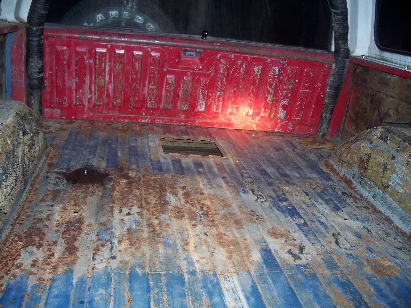

Pretty sure there is just the two in the back. The front has the hook. Hate to bring this up but you can always cut a access hole into your floor to get at the pump if your blazer is on the beater side instead of going through this mess
Old Jan 20, 2010 | 09:53 AM
Posts: 41,341
Funny you should mention that. My K5 has such a hole:
I would never do something like this on my vehicles, but since it was already there when I bought the truck, I plan on keeping the hole. I will be making it into an access panel with recessed bolts and a seal around the edge. The panel will be flush mounted to the floor when I am done with it. Right now it has part of a road sign over it (again, a bonus from the previous owner).
lol. yep thats how i got my first gas tank access hole. the guy had a fuel injection intake on it and thats how he changed the fuel pump... actually came in handy cause a year down the road the sending unit took a crap.
