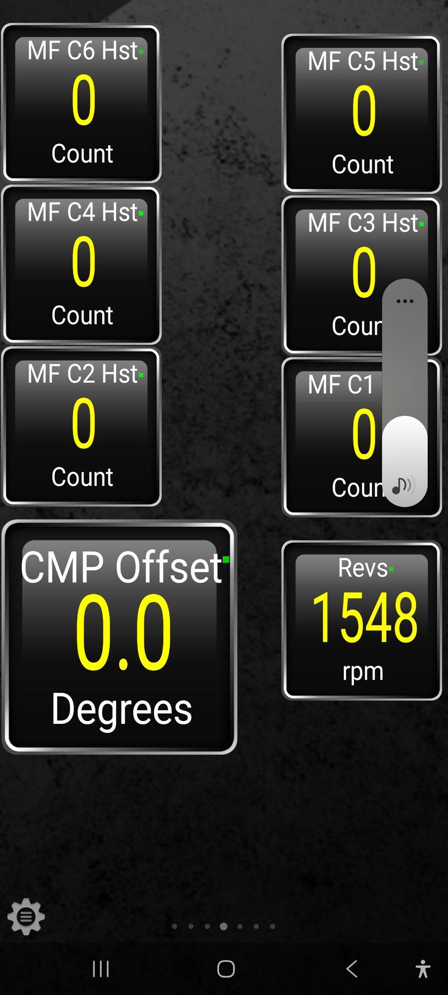

My dead eye dick positioning of distributor was good.
Photo is from Torque Pro.. Ignore the RPM. Engine was off when taking screen shot. Offset is 1.5 at 1500 rpm.

Adjusted CMP Retard to 0 degrees
