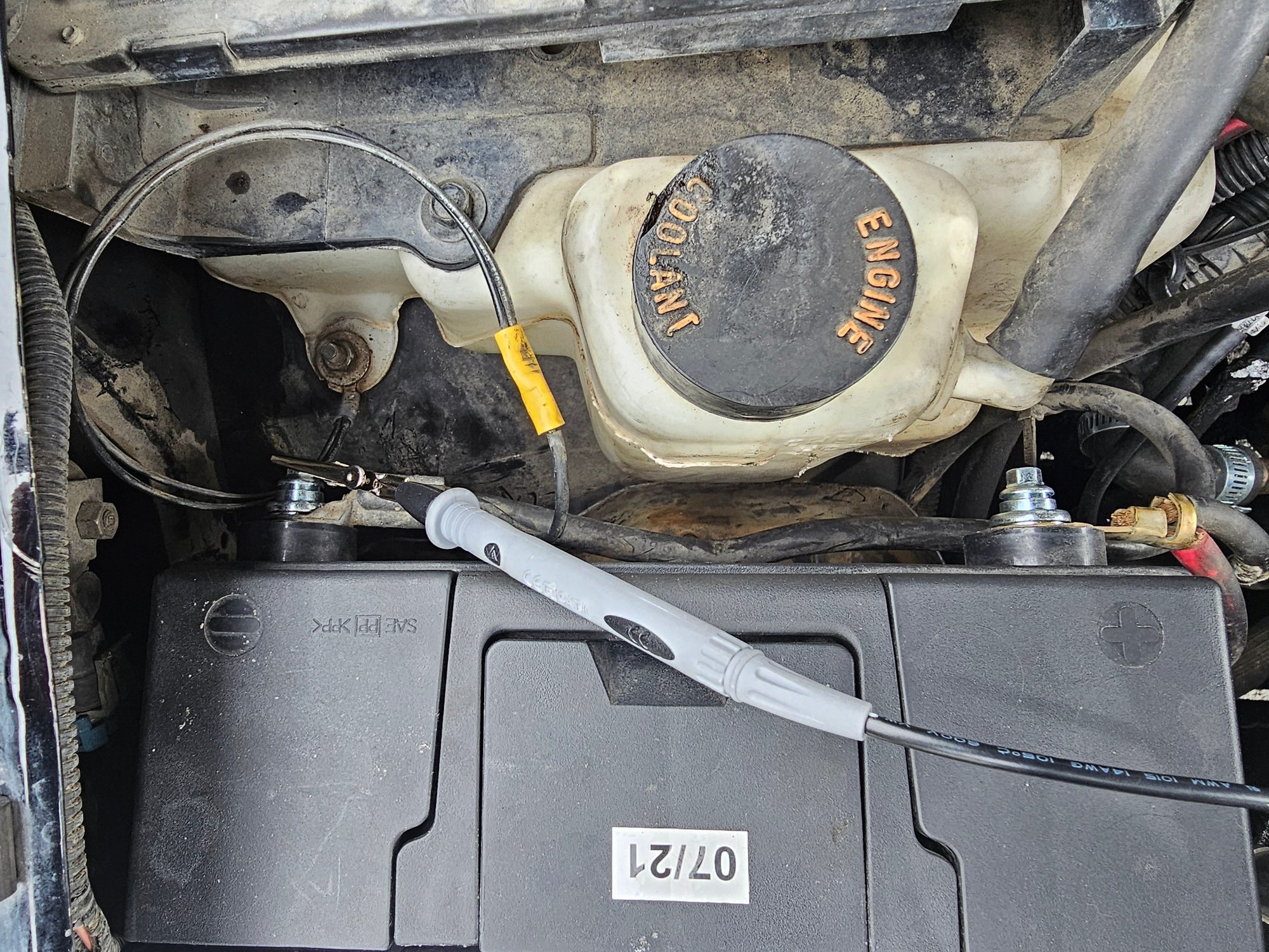

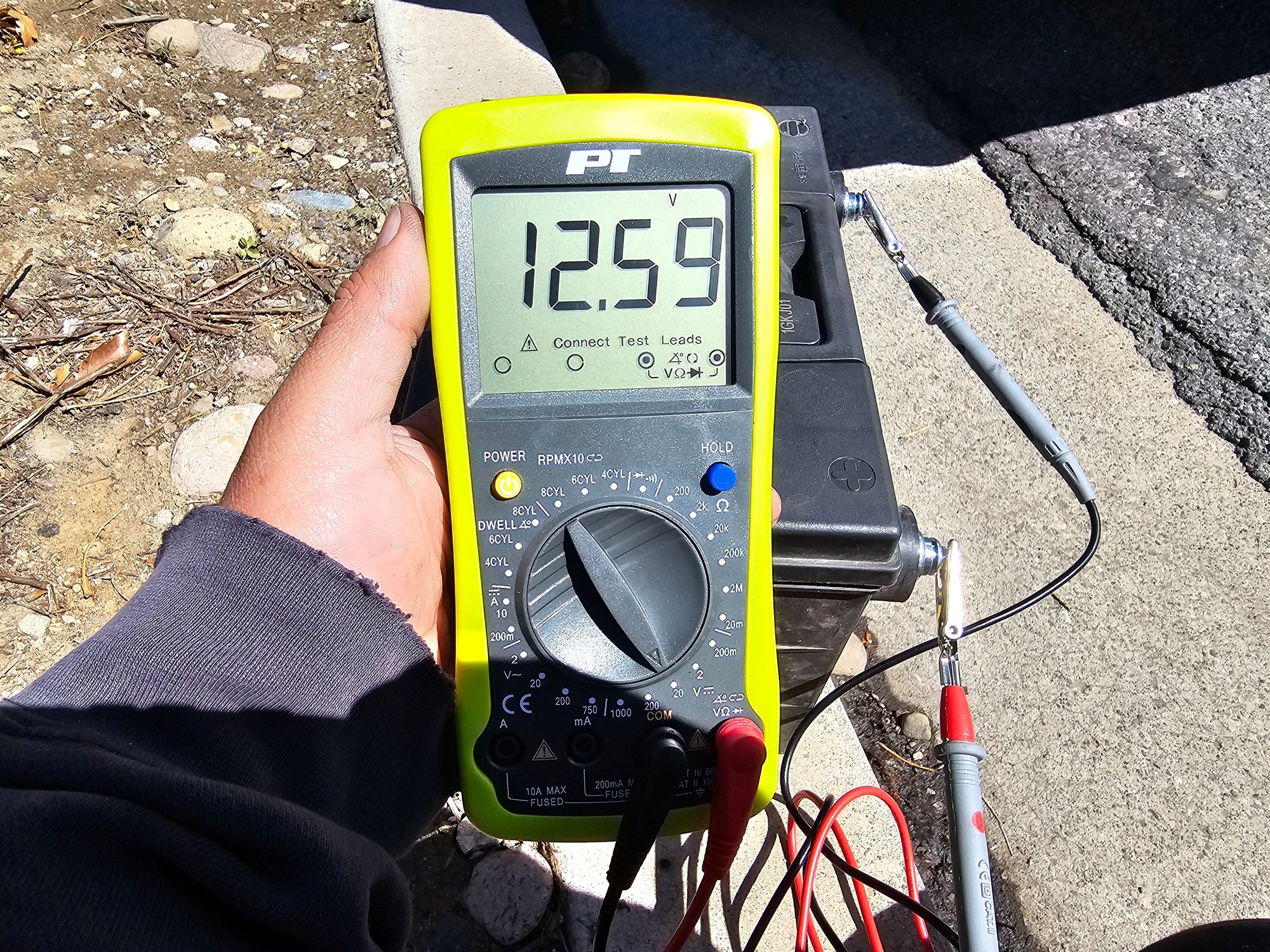

Hello George and Les. Thank you for the reply and I apologize for my late reply. Funky work schedule. So I had the battery out of the Blazer and did the voltage test and the battery was at 12.59 volts. I put the battery back into the Blazer and reconnected the battery cables and did another voltage test and it was still at 12.59 volts. Turned the ignition to the on position and volts did not move. Did the crank test and volts did not move still at 12.59 volts.

Next, pull the IGN A fuse (40A) in the UHFB and with the battery connected measure the voltage at the two fuse sockets, black battery probe to battery ground.

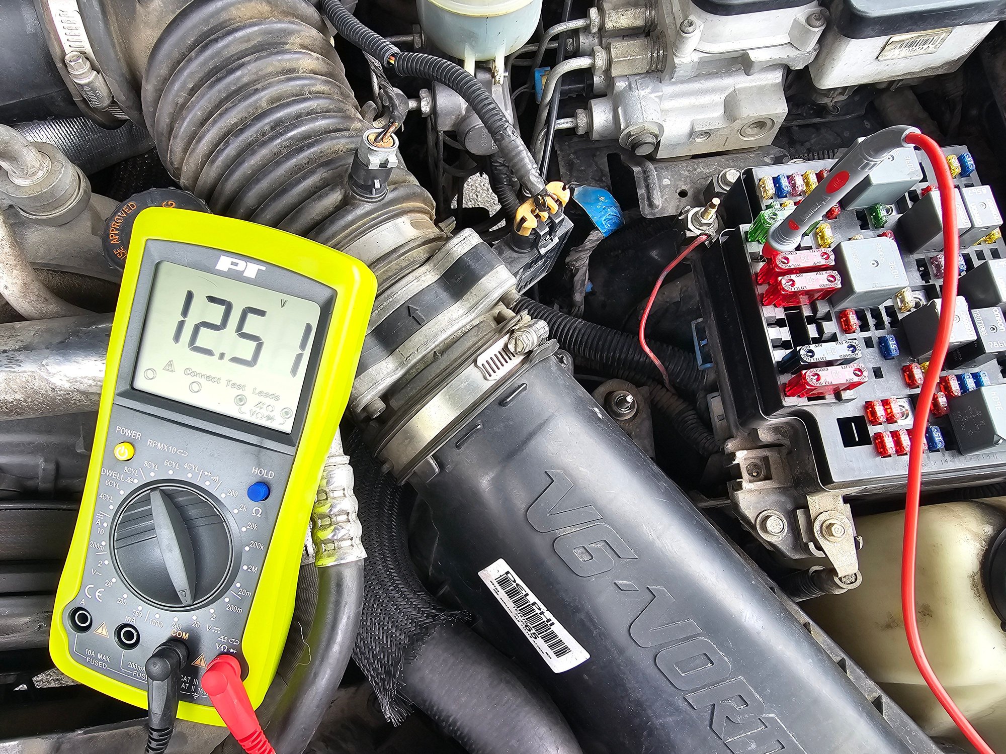

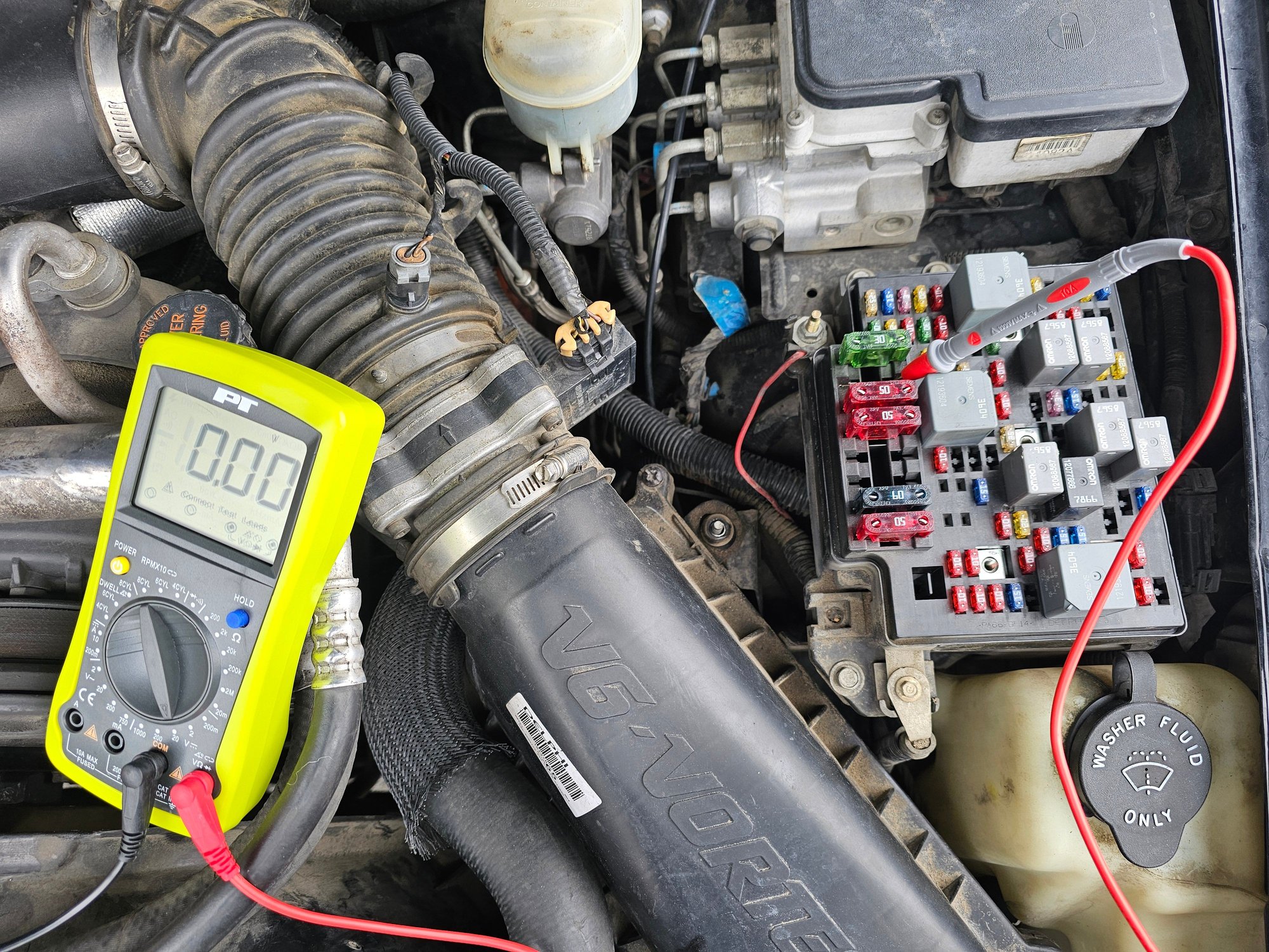

Good morning George. So pulled that 40A fuse and tested out the socket. The socket on the engine side tested at 12.51 volts and the socket towards the front frender side tested at 0.00 volts.

OK so we have a properly charged battery and the 175A maxifuse is OK, at least with no load. Next remove the ECM1 fuse (15A), turn the ley to run (key on) and test the voltage in both fuse pin sockets. Then turn the key to start and do the same for the crank fuse (10A).

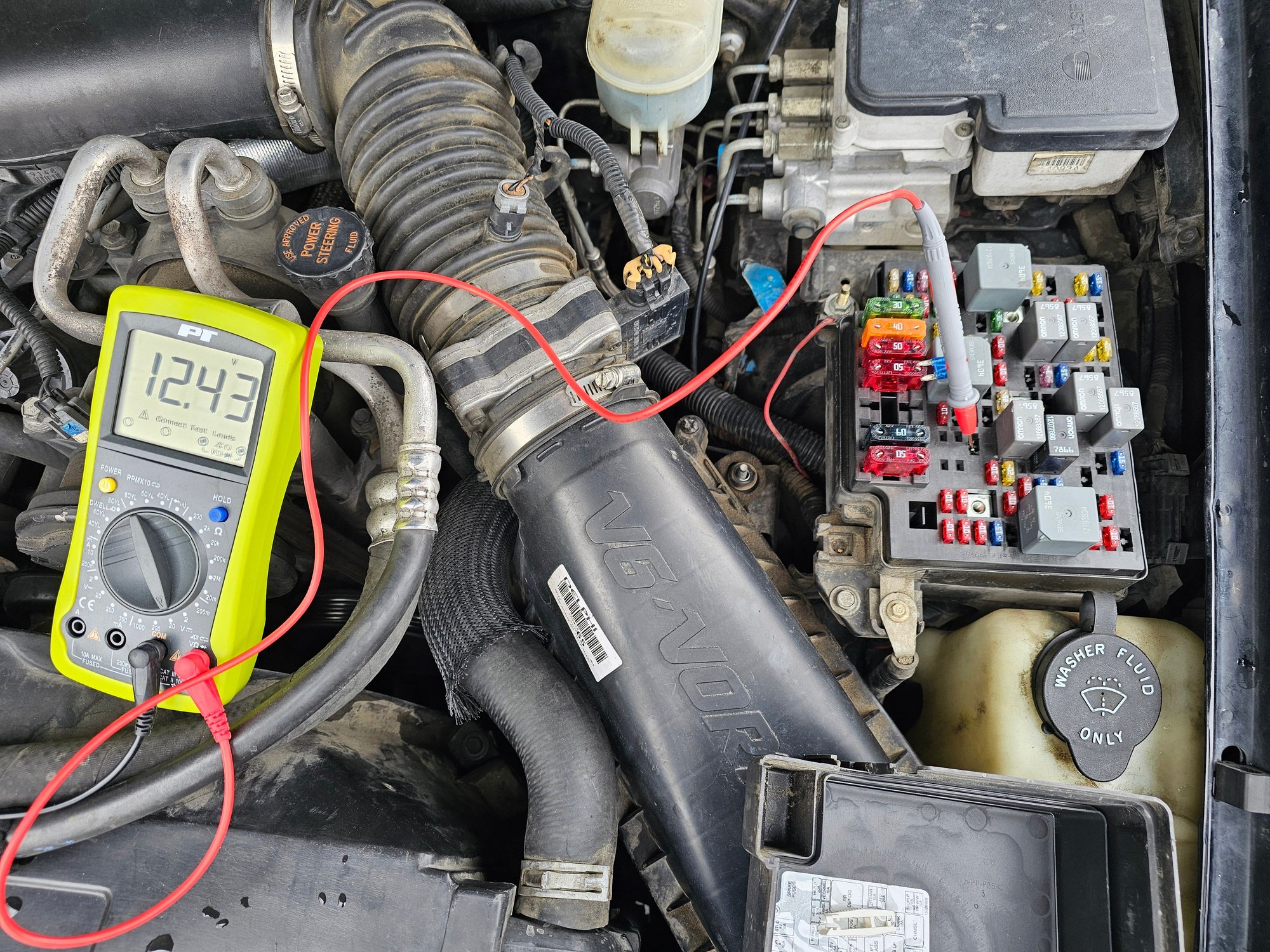

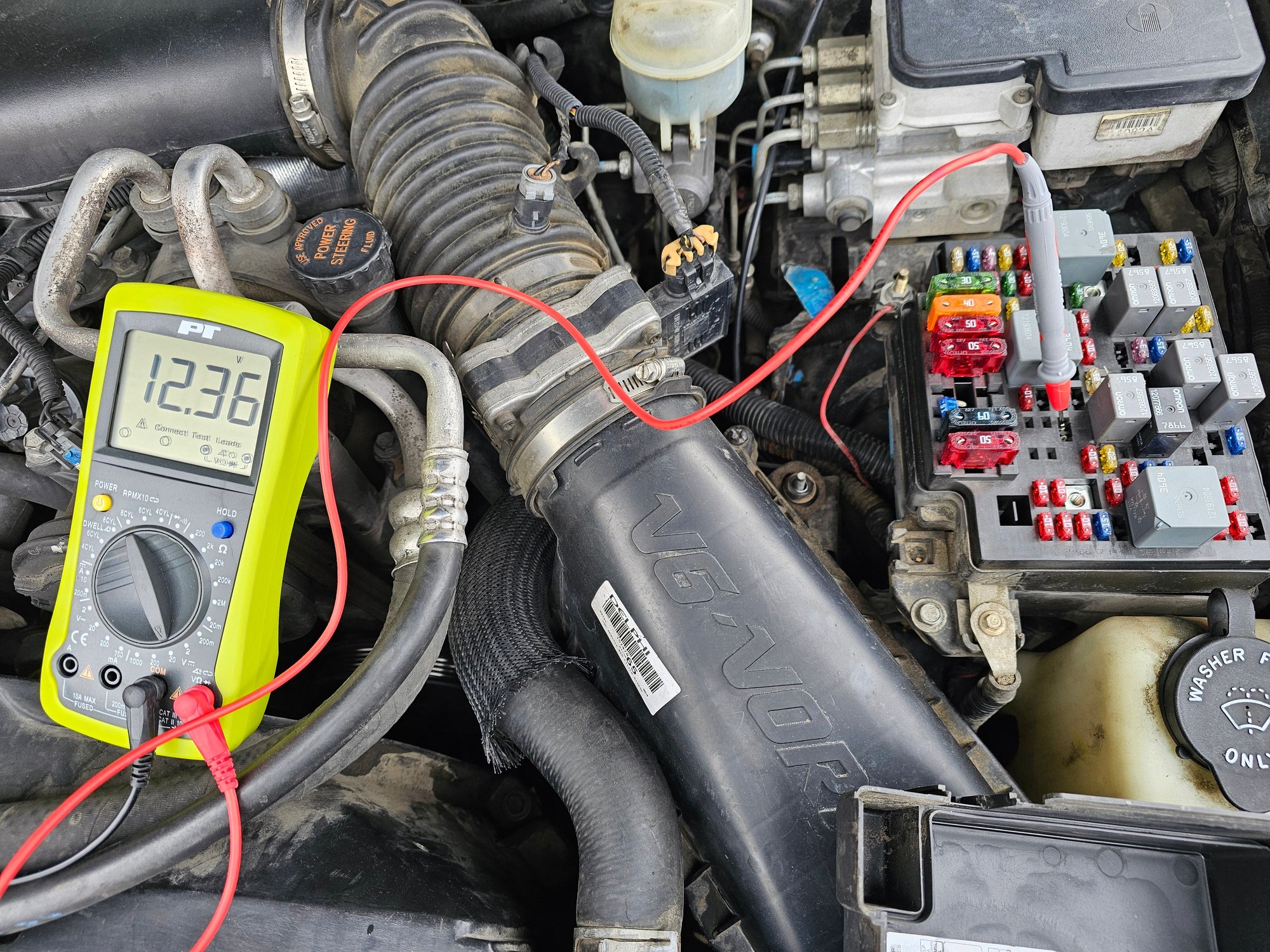

Good afternoon George. I removed the ECM1 fuse and tested the sockets with the key in the on position. Front socket tested at 12.43 volts. Back socket tested at 12.36 volts. Tested the 10A crank fuse next. Front socket tested at 12.37 volts. Back socket tested at 12.43 volts

So then your ignition switch is at least partially functional. Next check for clean dry connections for all three battery negative terminal attachments to the truck. Then pull the starter relay. One pin should have always on 12v. A second pin should have 12v only during a start attempt. Is this the case? Also, make note of the pins.
