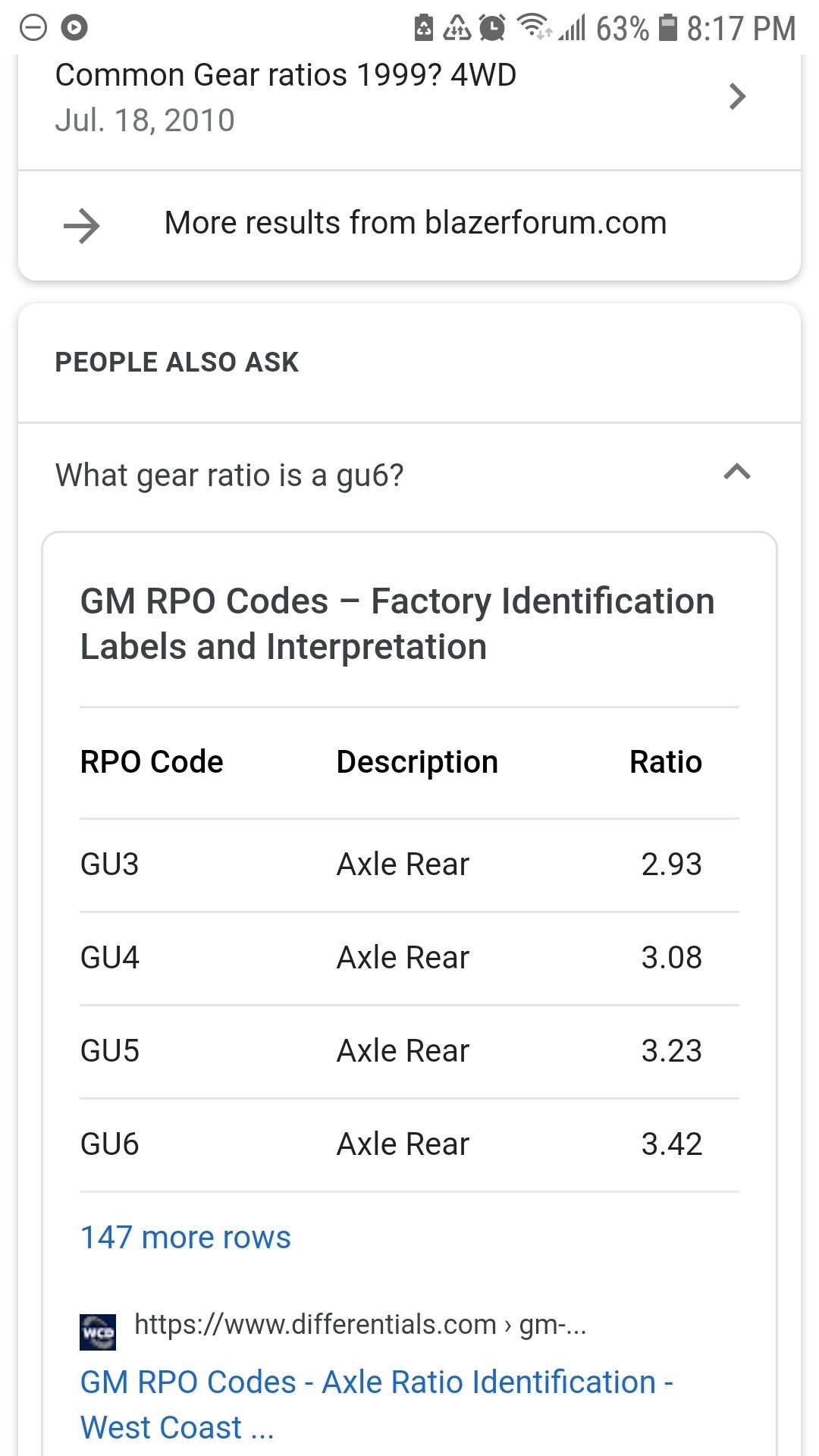

Old Feb 17, 2020 | 07:20 PM
You have a 3.42 rear end
if your looking for one, find one with the gu6 and the g80 code, itll have the "gm posi lock" as well as the right ratio
