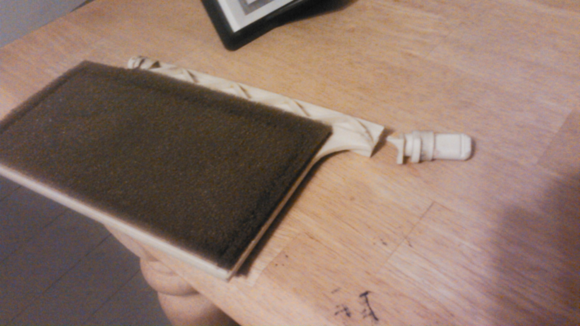

Here's the culprit, is this part sold individually?

To make this thread useful to someone someday the heat flapper is part# 52470781 and the heater core part # is 52473178. Thanks!

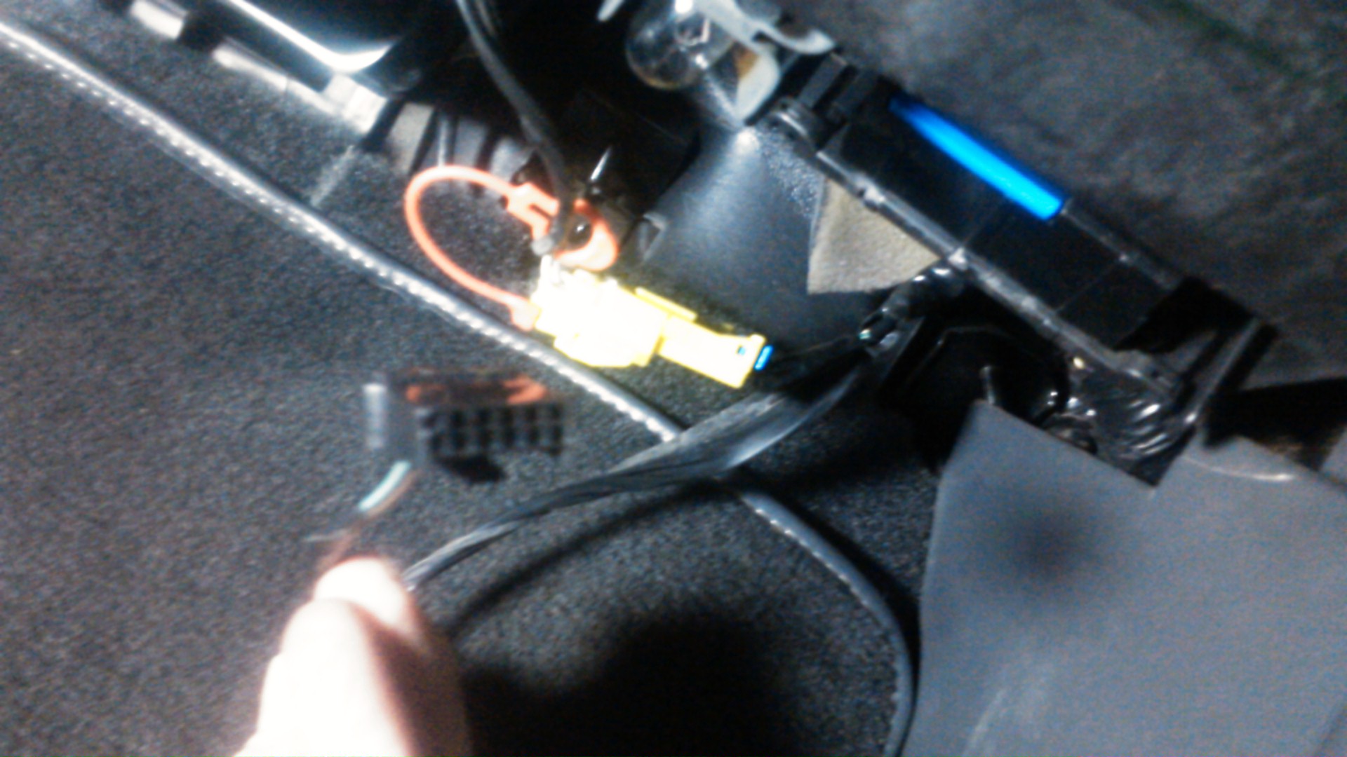

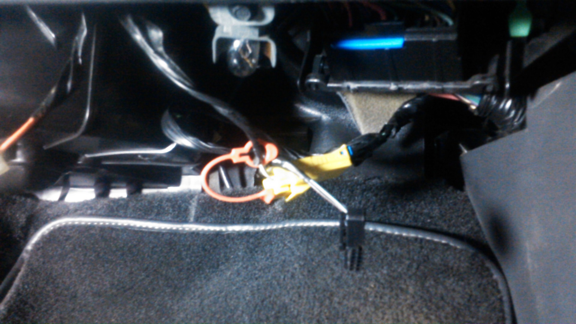

Thanks man, anybody know what this plugs into? Cant find the other end
