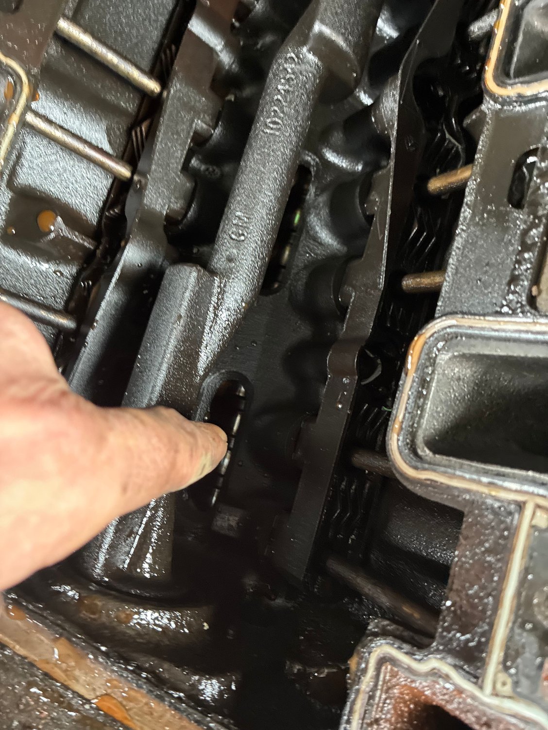

I droped an aluminum nut well one of the 2 nuts that hol the fuel line on the spider injector i droped it in the lifter valley where the cam shaft is it entered trought one of the 3 holes there is it gona drop in the pan or ...

Dang! Do you have a 4wd or 2wd model? I think I heard that taking off the oil pan on a 2wd model is not that hard. My first instinct would be to remove it. But if it fell to the bottom of the oil pan, I might not do that much damage as the screen on the oil pickup should be be able to keep it from being sucked into the oil-pump. But that is a lot of guessing on my part.
