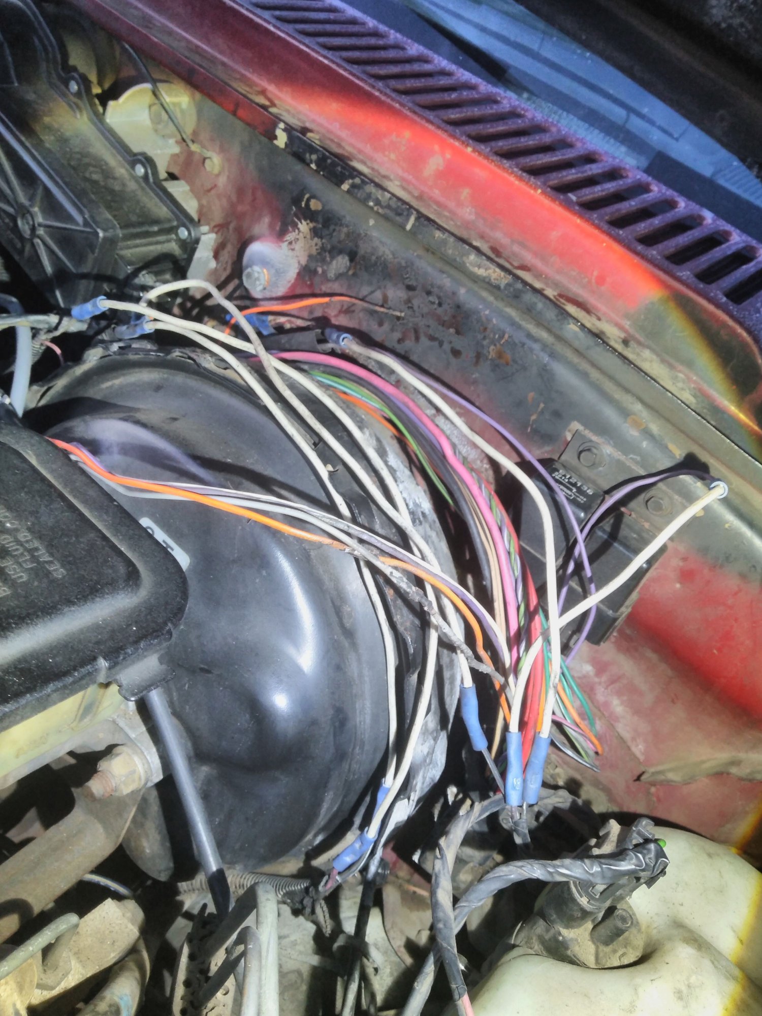

Ok where do I start on this 28 year old thing it definitely has funny repairs and sketchy looking black electrical tape and there was a fire in it over the break booster at some point and some wires are spliced back together with just white wire... If I can figure out how to post pictures I'll try but yea any advice is much appreciated it's my daily and I'm young and work full-time and don't have anyone to really help me out with it so anything to make my life easier is awesome thanks in advance for the advice

Old Jan 13, 2020 | 01:44 PM
Uh, oh! That looks bad. Definitively to check the whole of the wiring in the engine bay. Even corroded connections from the wrong input to the ECM will make it no-start or no-run.
Old Jan 13, 2020 | 02:28 PM
I'm crying for you my friend... that's a mess I would not want to deal with! Maybe see about a replacement from a wreckers?
