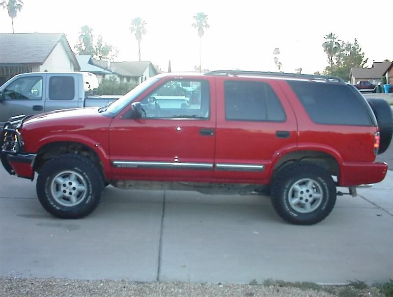

2" Body Lift, 1.5"-2" torsion bar crank, ~ 2" rear shackles, 31x10.5r15 BFG All Terrains
