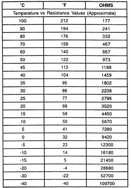

Hello I'm new here and want to start by saying hello.So I have a faulty gauge cluster I have replaced both my temp sensors,I cant get a accurate reading on my cluster so I want to use my mutimeter and check resistance or voltage off the sending unit itself that goes to gauge cluster to get its values and see what that translates into temperature.It seems like everytime I look up the values its for the sensor that goes to the computer and not the sending unit on the driver side of the block.Now today I drove the car for 15 min and let sit at idle for 5 mins and checked the voltage and resistance heres what my meter says.
I couldn't get a reading from anything other then 200mv as it seems to be reading under a volt.
volts
200mv - 08.0
ohms
2000k
012
200k
00.7
20k
.36
2k
482
checked it with meter set to speaker looking thing.the setting that beeps when there's continuity.
530
can someone please disipher and tell me what these values translate into temperature?

The "OHMS" column on the right, are the resistance values at the sensor, with the connector unplugged.
Attached Thumbnails checking blazer temp with meter on temp sending unit-ectactresistancetable.jpg
