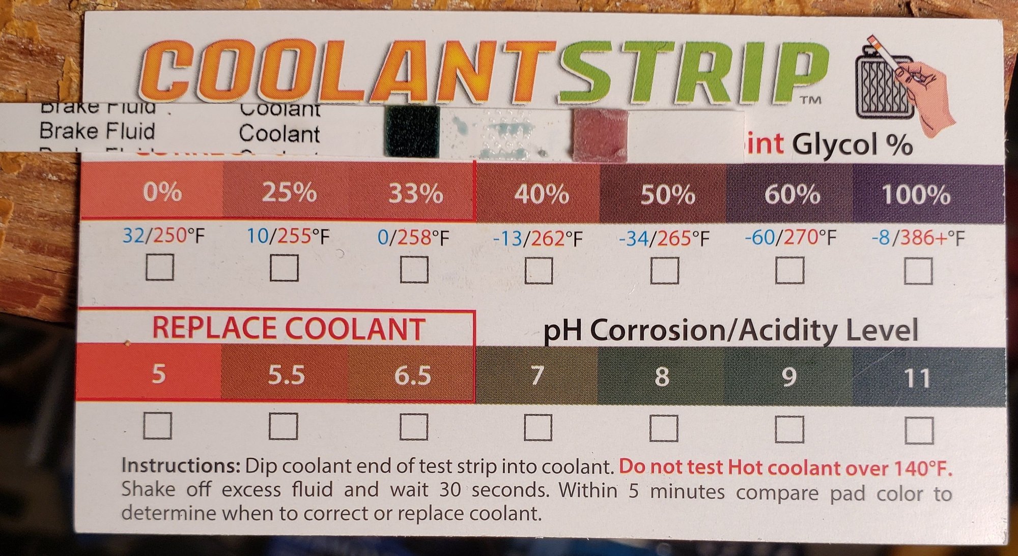

I got some test strips that test concentration and pH for the coolant, and the contamination in the brake fluid.
The current coolant, and brake fluid passed. I got these at NAPA. (Phoenix Brand)
https://brakebleeder.com/products/co...id-test-strips
Old Nov 11, 2024 | 08:02 PM
Posts: 5,645

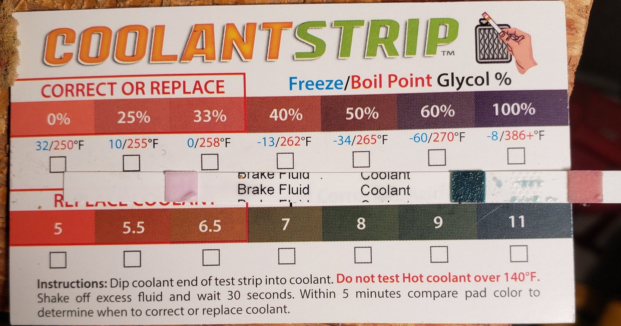

Here are the results of the tests I did with the strips.
Freeze/Boil point about equivalent to 45% concentration. I tested with a refractometer that I deem more accurate and it tested at 50%, i.e., -34F.
Freeze/Boil point about equivalent to 45% concentration. I tested with a refractometer that I deem more accurate and it tested at 50%, i.e., -34'F.
pH test of the coolant about 9, well above threshold for replacement of 7.
pH test of the coolant about 9, well above threshold for replacement of 7. The one thing that is confusing is that according to a Texaco tech document, the stand-alone pH of Dexcool is 8.3. Even if I allow for wide error bars, I figure I'm fine. (https://www.taligentx.com/passat/inf...fe_Coolant.pdf)
Brake contamination about 10 ppm, a factor of ten below the threshold. I had just added some fresh fluid though.
