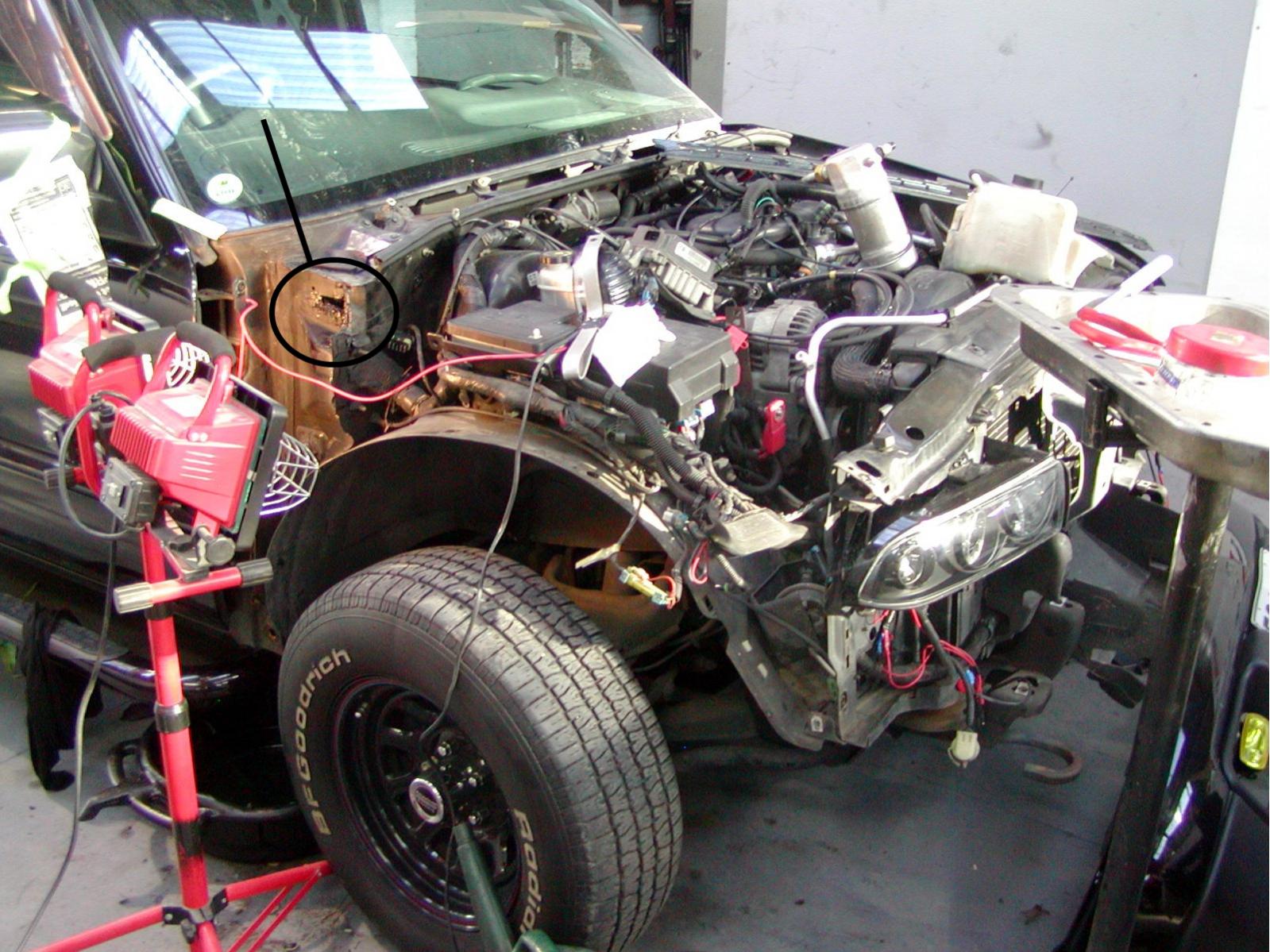

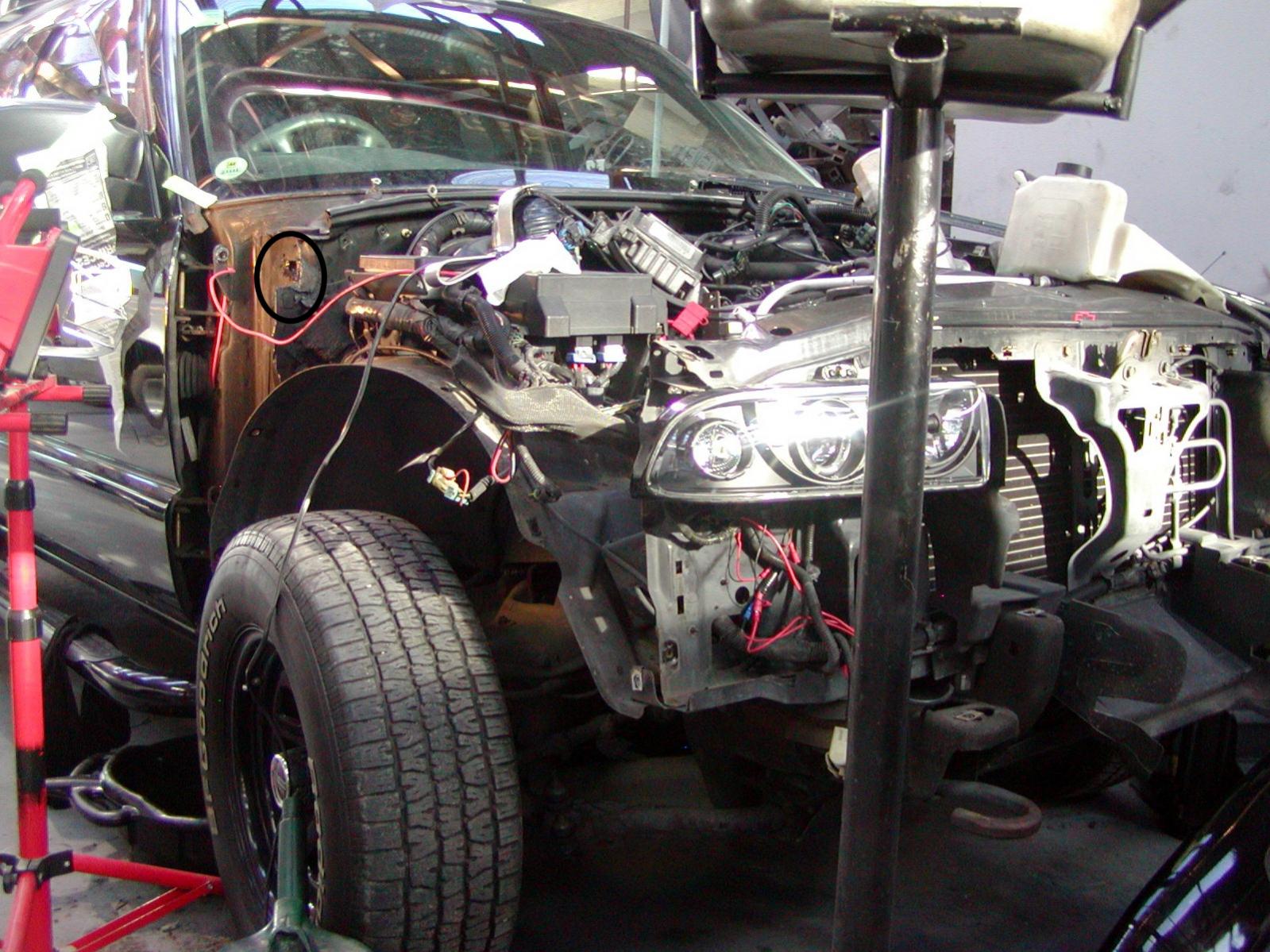

Popped in to the Chevy guys on my way home from hospital to visit my truck (in the Chevy hospital) & this is what I found.
The heater core was not leaking but .... the water was coming in from below the windscreen! there's a place (drain from under the windscreen) where a some panels are spot welded together & the seams had started to rust & parted slightly - just enough for water to get through, unfortunately, into the truck behind the pedals. So they've applied some sealer which needs time to cure before they can put it all back together.

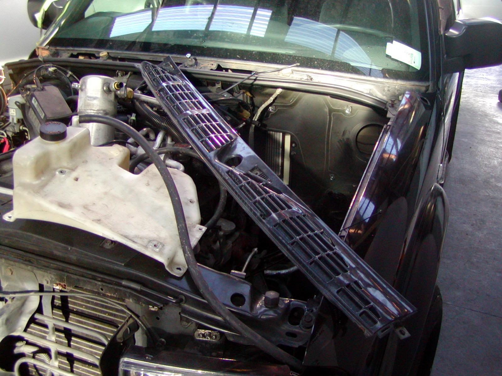

This was all helped by a build up of pine needles in the grill under the windscreen.
As for the air conditioner, they've done a pressure test but now suspect a seal is gone in the compressor. $$$$$$$$$$$! I gonna cry when they ask for their money!

Damn! They pulled your HVAC system apart only to realize that it was not the source of the leak?

Yea. Since I told them the heater core was leaking they jumped in & when they flipped the dash they saw evidence of water entering above the pedals & realised that the problem was elsewhere. So thy put the dash back together & whilst they had the AC radiator out they had that pressure tested. That checked out ok.
