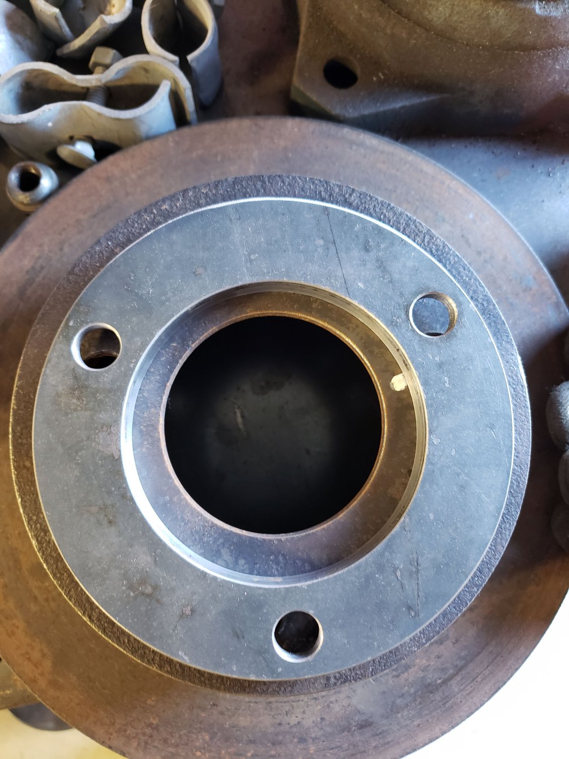

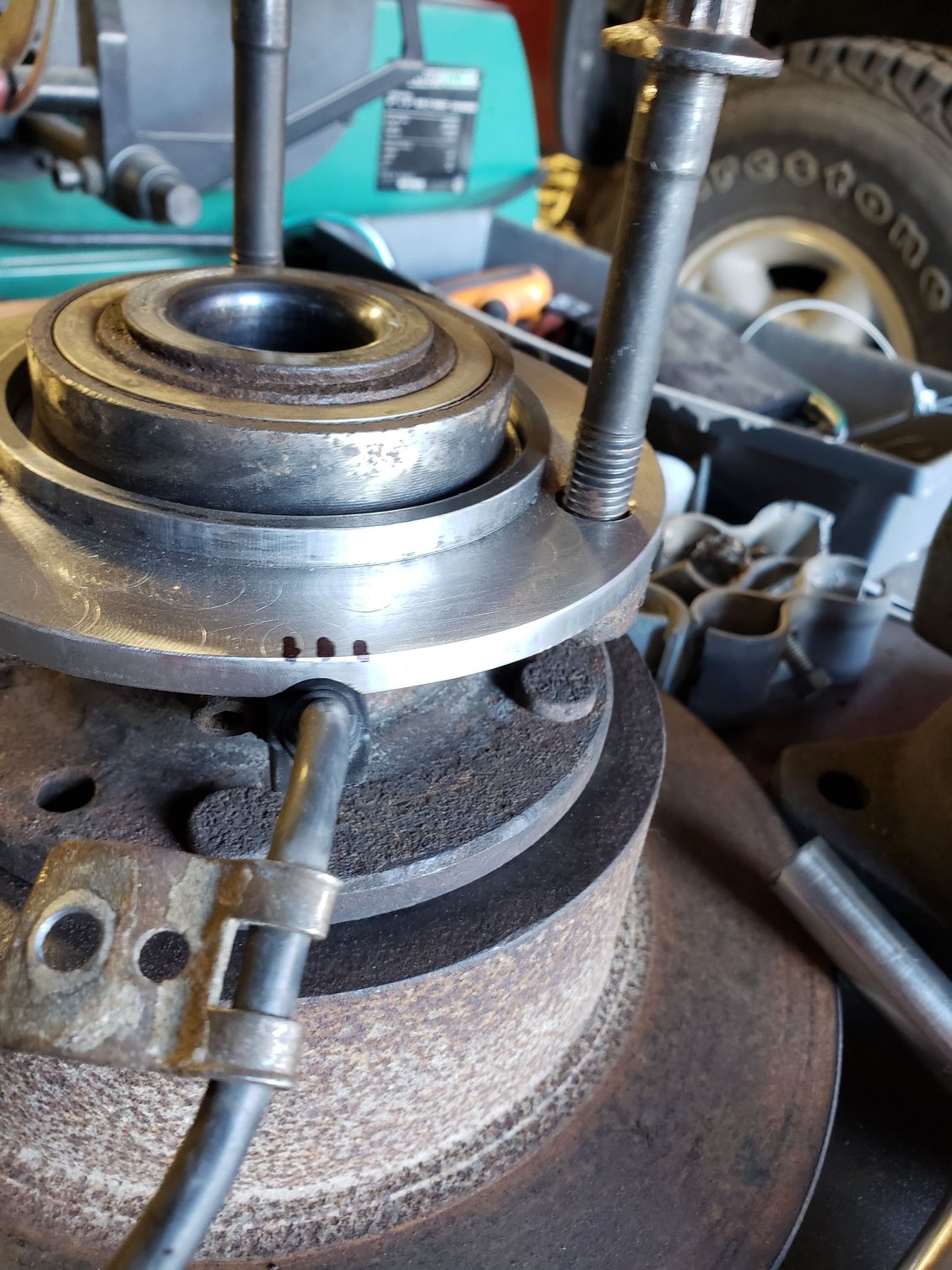

Made some adapters for putting S10 hubs into a Dana 30. These allow the use of stock S10 hubs and wheels on a SAS Blazer of S10. You can also keep the ABS at each wheel with them.

Pretty soon I'll try and get a pic of the Dana with the adapters installed and wheels in place. You do have to rework how you attach and route your ABS wiring though. Not a big deal but something to be aware of. The ABS sensor wire exits the hub at an angle which complicates it somewhat.

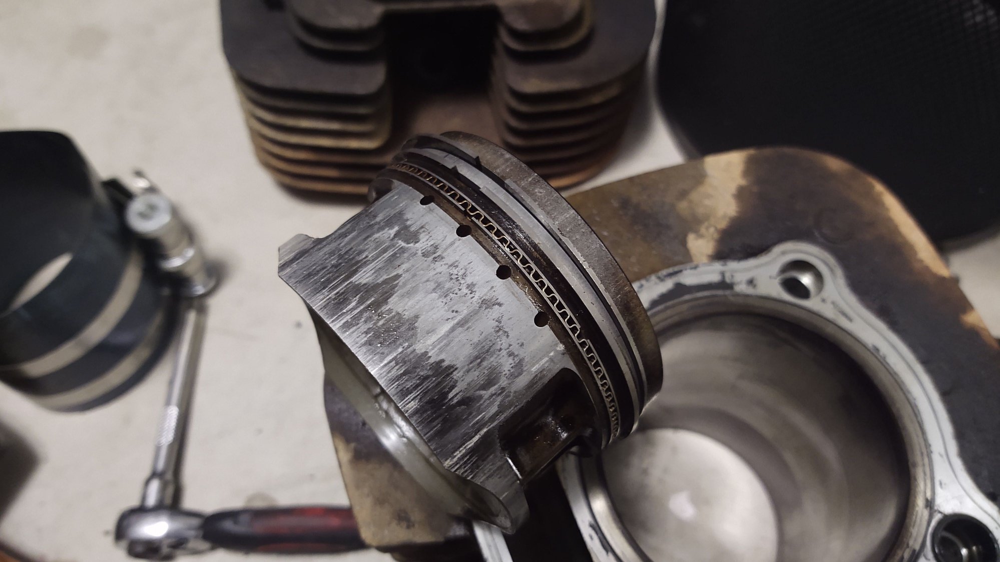

Got the project ATV fired up finally after getting the clutch issue all sorted out and reassembled. Only to hear a nasty sound coming from the internals and find it burning oil and smoking... Sounded like it was coming from the top end, and I read a lot about these motors developing piston slap. So I drove it (for the first time mind you lol) straight into the garage and started ripping into it, with the help of the wife she wanted to get her hands dirty lol.
Took about an hour of wrenching, pulling some plastic out of the way and what not, and we got the top end pulled off completely.
Found MAJOR scoring on the piston skirts and some markings on the walls of the cylinder. Safe to say that's where the noise was coming from... I can wiggle the piston around in the cylinder an uncomfortable amount, so that was probably contributing to the noise too lol. The oil control rings on the piston also seem like they're not right. Not locked up, but they don't expand out as far as the compression rings, so that might be where some of the oil burning was coming from. That and I'm sure the valve seals might be a little to blame too.
There doesn't seem to be any abnormal play on the rod and the crank, so I think all that is good to use.
So now it's time to pull the top end and piston off the donor motor to transplant onto this one!
