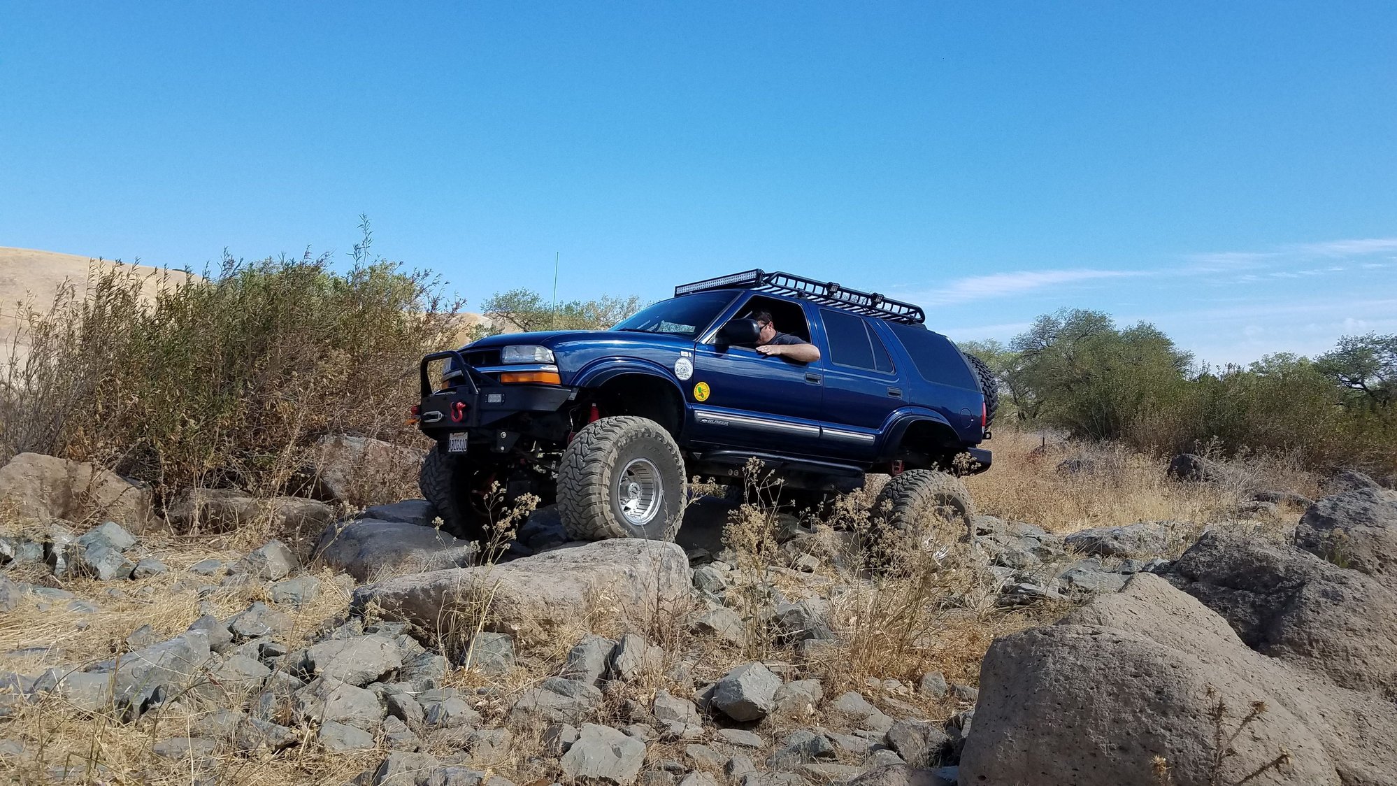

It's pretty easy to weld light tabs onto square tubing. I thought about making my own rack, but there were about a million different ones on Amazon that were pretty reasonably priced, so I just picked one I liked and bought it. I also bought clamp-on light mounts for the size tubing the rack was made of and installed them at the joints for extra strength. Like most racks, mine was meant to attach to the OEM roof rack, but I took off the stock rack and made my own mounts to keep its profile low.
Not the best picture, but you can kind of see the roof rack.

Wow, killer ride, Tom A!
