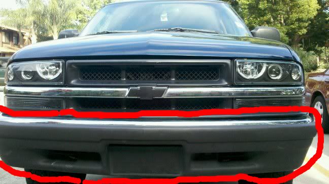

Old Dec 30, 2010 | 10:47 PM
ABN31B's Avatar
Posts: 3,545
From: Tacoma-ish
Talking
see pic
Attached Thumbnails silver front bumper paint/bedliner-zzz.jpg

i moded the pic because it was easier than trying to explain
impact strip: little plastic pre-bumper that absorbs light impact (think shopping cart) so as not to mar the metal. in a collision it gets toasted. i was at home depot and got bumped (i believe) by someone that went too far through their parking stall. split the strip but didn't mis-align my bumper any...
it's not BAD if it breaks, you will just have a series of unfilled holes lining your bumper from one side ot another. I have had mine off since it was hit (bought it like 4 months earlier for $14 from rock auto) just said F-it since then. God has not struck me down yet
a valance is a plastic lip that lives on the bottom of a bumper. it's sporty looking, dresses things up, and helps with aerodynamics to an extent. sit near a curb or sidewalk in front of a building and watch sedans park by it. the thing you hear scraaaaaappppping against the concrete <-- thats the valance

theres 6 bolts you must take off to get your bumper off. you have to remove your grill then there is 2 centrally located. then theres 2 set out a little bit, then go to the side of your car in your wheel well theres a bar connecting your frame to the bumper so disconnect it at the bumper not the frame otherwise its a pita to get back on later
Old Dec 31, 2010 | 01:00 PM
ABN31B's Avatar
Posts: 3,545
From: Tacoma-ish
yeah FOGEL is right and i guess i should clarify the X on the pic above indicate the bolts that hold the bumper on. sorry if that wasn't clear before
