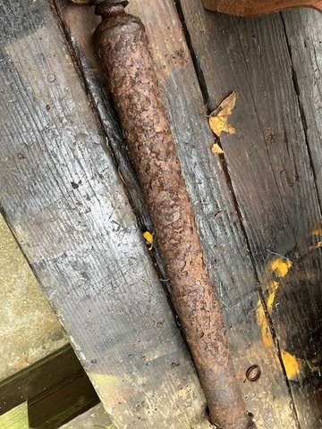

interesting,,hard to believe a drive shaft could look like this...lol...
Right?? LOL
