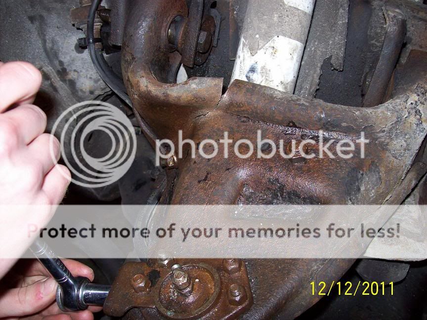

So today a friend & I R/R the DS upper control arm woo hoooo!
The tear had gotten worse since Saturday driving from work to home & back to work today.

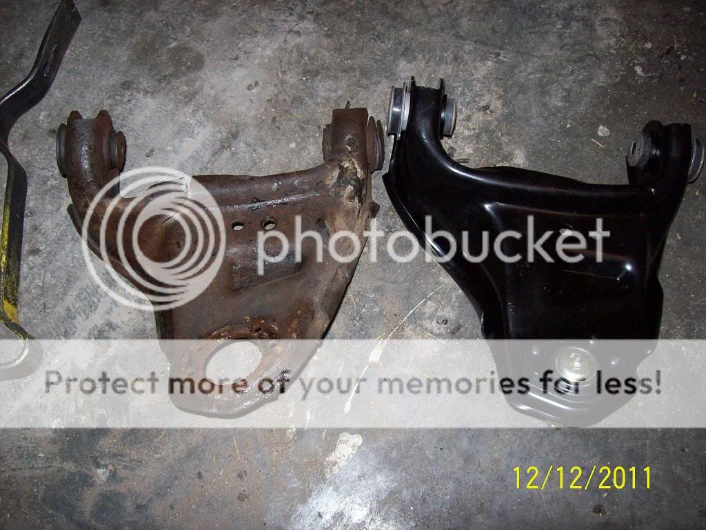

Here's a side by side comparison - YIKES!

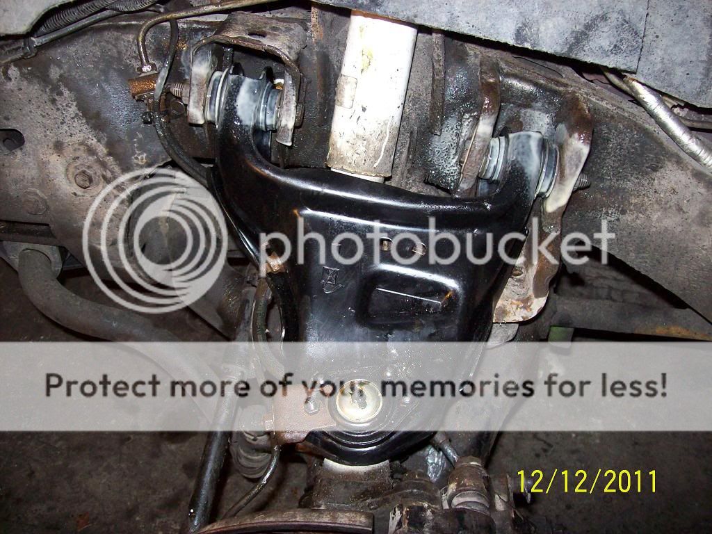

& finally the new installed upper control arm
It drives straight now & if I let go of the wheel it doesn't want to make lane choice decissions for me anymore lol. I might have to hit a few good speed bumps on that side & see it it squares up the tire because it's a little in at the bottom. That or I'm used to seeing it like

Holy Jeebus man... another couple days and that sucker would have ripped right off!

Eeeyup, ripped off &/or a catastrophic failure IE: tire into the fenderwell at ??? speed. AND I drove it to the States last weekend!
Like I said before the amount of rust around the crack tells me it was bent before & straightened out. That just leads to metal fatigue & makes it weak. I'm surprised it lasted as long as it did with the 32's on 10" wide rims & a T-bar twist.
Surprising when you look at the pics from Saturday as compared to today & I drove it only around 20 miles or so.
