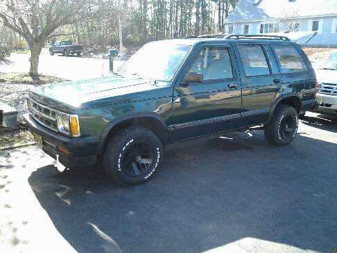

Would you buy a Blazer that won't start due to a "bad ground?"
Attempting to fact-check this BEAUTIFUL truck.
What on earth could be wrong why this thing "Won't start?"
My first thoughts:
1. Locked/seized engine .....
2. Bad starter ?
3. A wire really is off (would not crank at all.)
Your thoughts?
93 s-10 blazer,in great cond..4x4
My first thoughts:
2. Bad starter ?
Your thoughts?
If he has receipts for all the "new" parts, that truck might be worth his "firm" price if it was running.
To eliminate your first guess (unlikely, but check), take an appropriate wrench and turn the crank by hand. If anything feels funny, RUN AWAY.
It could be a bad starter, especially if the receipt is for a Made in China "Lifetime" starter from one of the discount auto parts stores.
It could be a corroded through/broken/missing ground strap, as well. If it was a first or second generation VW Golf/Jetta, I'd say look for the melted/charred speedometer cable that serves as "secondary ground" for the starter. I'm not sure what burns up as a secondary ground path on these vehicles.
One way to diagnose a missing or corroded ground strap is to hook a single jumper cable between the negative battery terminal and a big ground point on the engine (the lift tab on the drivers side near the front, if it's there). If it starts with that jumper cable, it's a bad ground strap.
