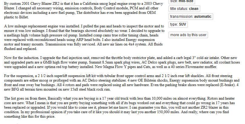

Here is what I am going to look at...
Old Oct 13, 2018 | 12:25 PM
Posts: 5,644
Could be a good buy if no rust and at the right price.
