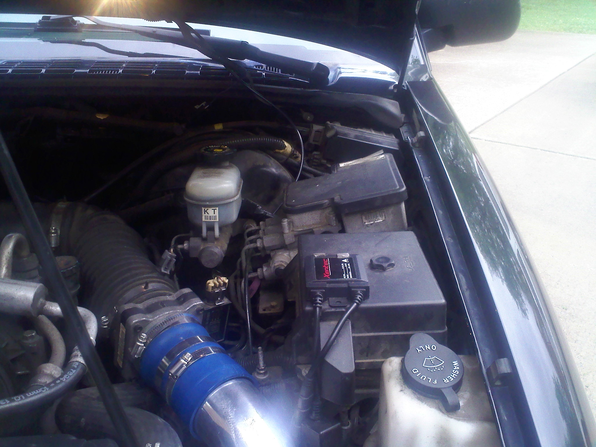

I just did a 2" BL to my 99 blazer and was wondering if the brake controller in the engine is supposed to be crooked now (it's bent down toward the engine). Before I did the lift, every thing was perfect and now I have a really bad rough idle (shakes constantly no matter which gear it's in and I can feel it shaking in the steering wheel as well). Not sure what I did wrong, but I did skip the directions to relocate the power supply on the passenger side below the battery. I might have missed a couple of the brake line clips if that could do it. I also have a ticking or popping sound (coming from the driver side dash) every time I hit the smallest bump. If anyone has a clue what went wrong that would be greatly appreciated!

Looks like you didnt remove the hard brake lines from the bracket that I think is attached to the frame. Follow the lines and you'll see the bracket I mentioned. Like I said in the PM, just go through the directions again to make sure you didn't skip anything.

Alright I relocated the power supply, but still it shakes like no other. Also, the engine is slanted up toward the front, Is it supposed to do that? I found a few more brake line clips to take off, but still no luck. There is a wire/line that goes up into the body directly underneath the driver seat and it is very tight. But I have no clue what it is.

That wire could be the ground wire for the ABS. My engine isn't slanted at all. Maybe broken motor mount? Not really sure why it would be like that. Check the motor mounts.

I'll check the motor mounts out tomorrow, but it's just a slight angle. I'm leaning more to my vacuum hoses. I found one a few weeks ago that was split in half and another that was starting to crack everywhere. I'm going to O'reilly's to get new hose tomorrow as well. Or it might be the distributor cap has gone bad and is leaking.?????? We'll see
