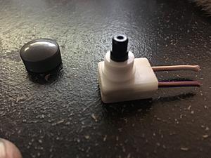

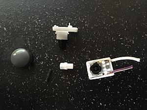

Map Light switch

Problem Fixed
I was unable to locate a new one or even a part number to beable to order one online. So today I went to the local U-Pull It.
Cost me $2 to enter. $5 for the switch so $7 total.
This also allowed me to experiment with how to remove the overhead console. If I broke something not a big deal I just won't do that to mine when I take it down.
There is 3 screws holding it up. One in the very front up by the windshield. Then 2 behind the dome light. Be ready to catch it when you remove the last one.
I did the one in the front first so the weight of the console didn't hinge on it and risk breakage.
Once removed, unplug the 2 connectors. One for the lights and one for the compass/thermometer.
With the console in your hands and still upside down. You will see multiple fasteners around the outside edge. On the 97 that I took it out of they were #2 Philips. On my 2000 they were I think #4 torx.
Once you remove those, open the door furthest on the back. The big shallow compartment that I am not sure what you could ever put in there and be convienant. Once that swings open the plastic part and upholstered part separate.
now you can see all the switches and connections.
To remove the switch simply slide it to the rear. I cut the wires and spliced in the new one with solder and shrink tubing. Slide it new switch and assembly and install is reverse.
Happy Blazing folks!!!

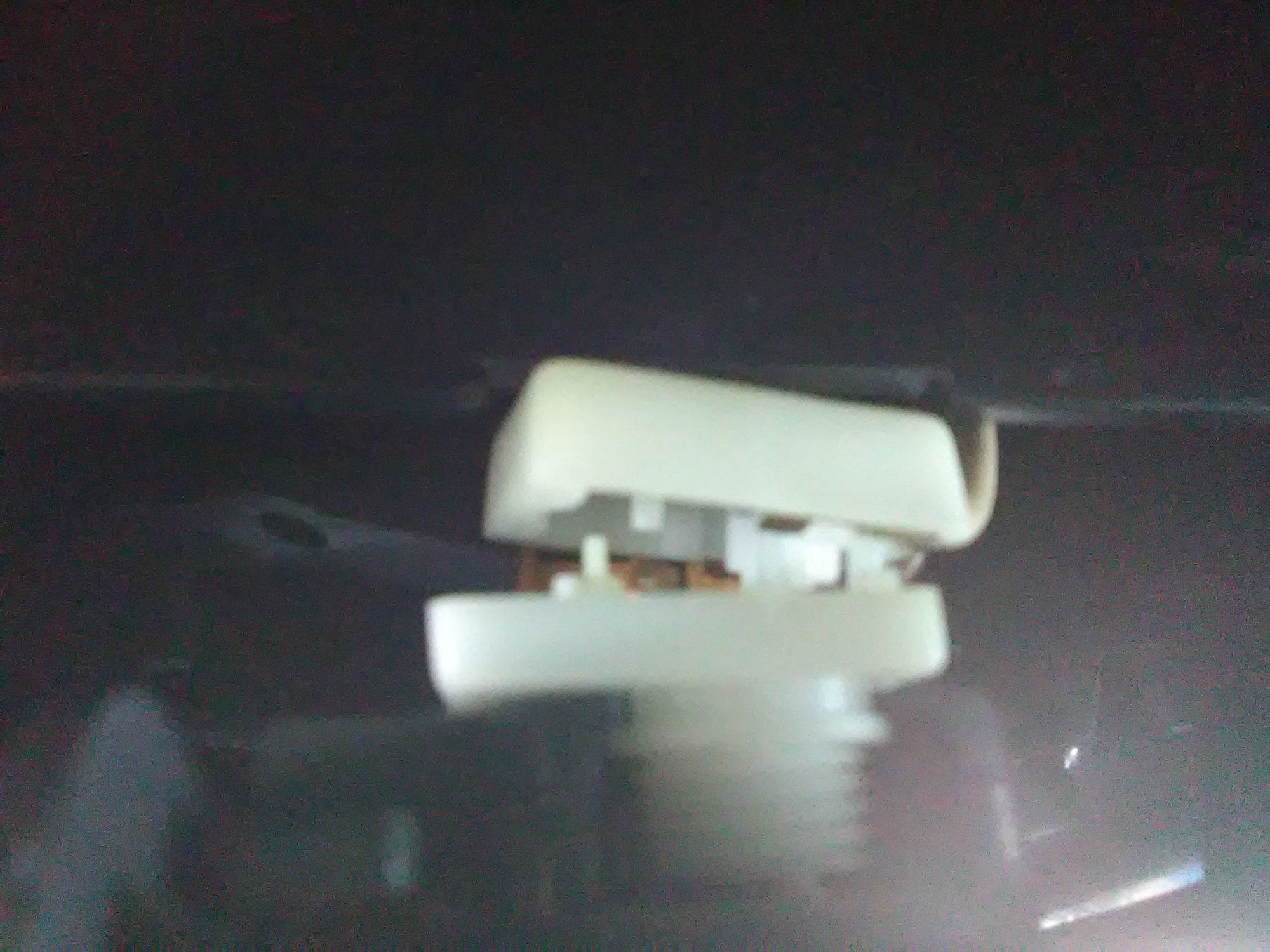

Before super glue and after super glue.
Attached Thumbnails 2000 Blazer Map Light Switch-file-5-.jpeg   2000 Blazer Map Light Switch-file1-1-.jpeg
Very nice! Probably could have saved myself $7 and an hour round trip drive plus time to pull it from the UPull it yard.
