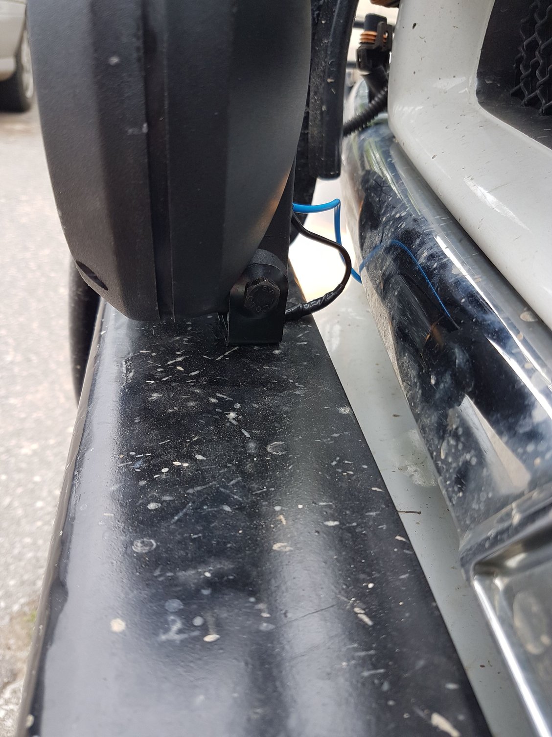

Ok, so it's not a finished product, but I wanted to do a little to see if itll even work like I wanted, and it does.
So for a test, I stripped some wire off the positive to the fog light wire, and added my positive to my aftermarket wire.
I grounded the light to the mounting bracket and brush board.
The lights come on with my factory fog light switch.
Ground wire
Positive wire
Turned on(passenger side not wired yet)

Got it all installed.
Positive from aftermarket to positive of factory.
Negative of aftermarket to ground on brush guard.
Will take nighttime pics when it gets dark.
