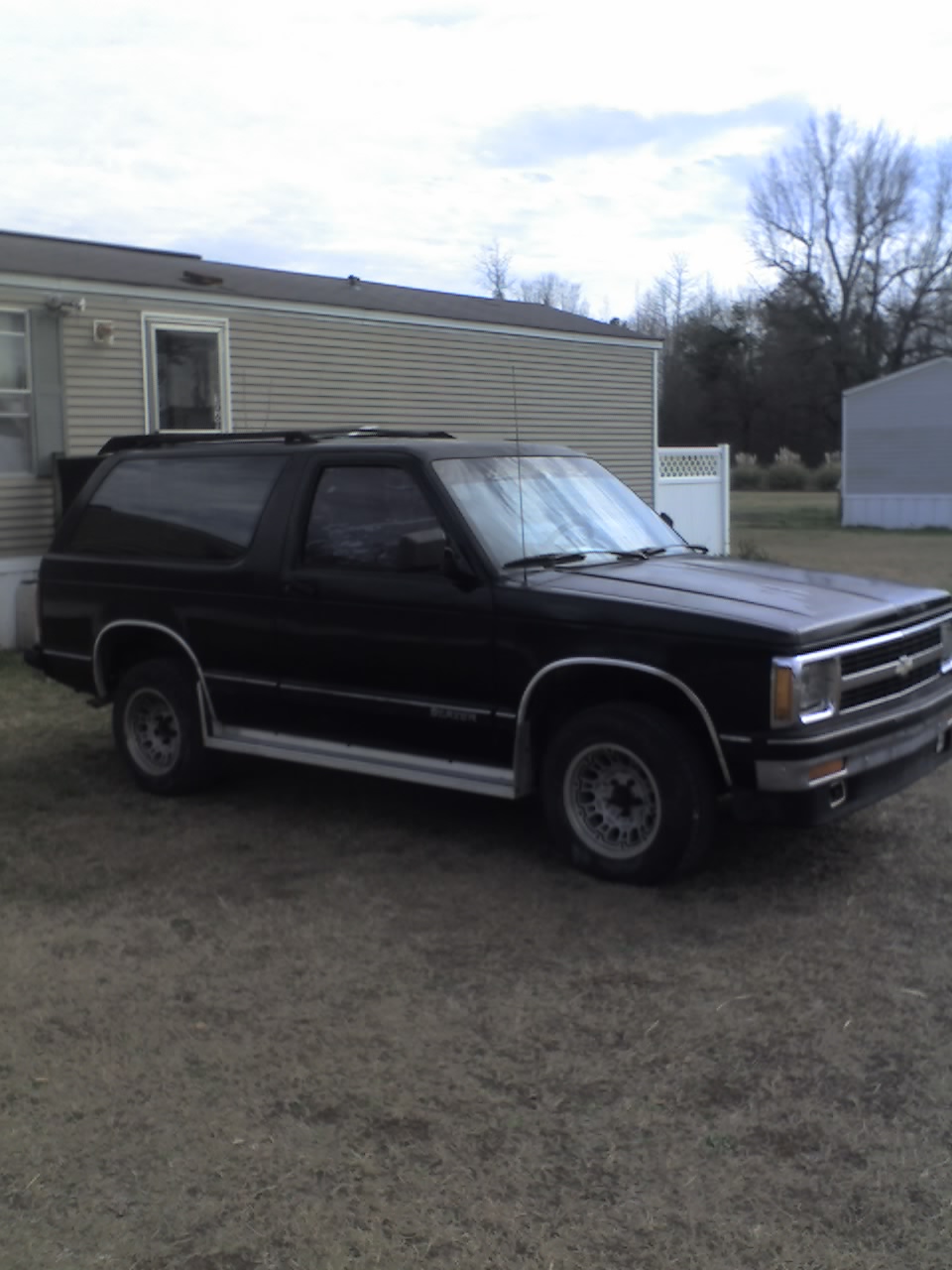

Default Not bad for 21
Here is a pic of the 1991 S10 Blazer I am working on, guess you can see why I am really wanting to get this baby on the road again. I know should have cleaned the tires first
Attached Thumbnails Bunch of problems after replacing engine-012.jpg   Bunch of problems after replacing engine-013.jpg
