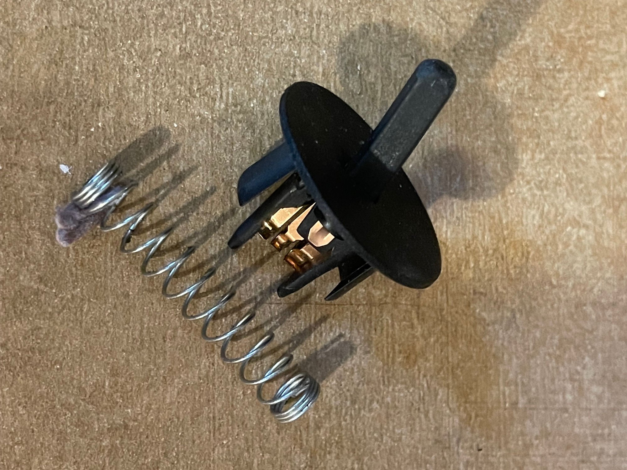

Well, here's the way I like to make a bad situation worse: I went to check the "switch" which appeared to be nothing more than a protruding nub of plastic popped in below the fuses by the driver's side left knee. I thought " there's no way that could be passed off like a switch." Wrong. I popped it off and indeed it's what triggers the driver's door is opened or closed. And now it's not going back in so easily.
So before I make matters worse, is there another area I should inspect? You said that just pulling the handle should set off the interior lights, which it wasn't doing. Same with popping the rear glass. Or any door. Is there a main switch I should be looking for? Perhaps a blown fuse? (I kind of count it, but I don't want to rule anything out at his point.)
Thank you for your help and time with this matter. I sincerely appreciate it.

Well, that switch is broken, so no, its not going back in easily, assuming the body of the switch fell into the dashboard, going to have to retrieve that..
Check fuses absolutely, and if no yield then check your BCM wiring as it may not be outputting power to the system on switched command, i dont have a wiring diagram handy but one has been passed around several times, i'll try and locate it.
