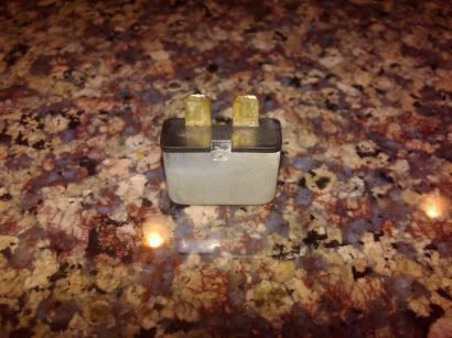

Alright, so when I pulled the ACC fuse out, it looks like this:
I haven't seen a fuse like this before--can you find one at any Ace hardware or Lowes?

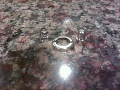

As for the cigarette lighter, here are the pieces that popped out:

I went to look at the cigarette lighter, and it turns out the pieces were from the CB adapter, so all is good. Thanks for the help!
This is a no-no
This is a self resetting breaker type fuse. Use a standard fuse instead. You blew other fuses because this thing will keep resetting to work again. I know first hand what can happen when wiring goes wrong with these things inline. It will repeatedly click on and off so fast, that it really doesn't interrupt the power flow at all. I've seen a guy come in to a shop where I worked years ago with a burnt trunk because he put one of these on his amp. He was complaining about his amp fuse blowing, I told him we need to look at the amp, he didn't want to pay for repairs... Now he has no trunk!
Please Please Please Please put in a standard fuse... I'd hate to see pics of a toasty blazer here...
