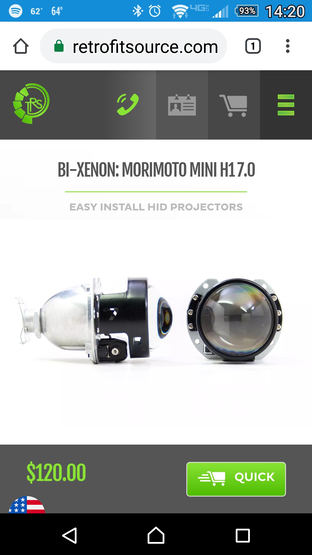

I have never seen ANY aftermarket projector headlights that have projectors in them that are worth a crap... They're made purely for looks and not light output.
I've seen people take those headlights, open them up, and install REAL projectors into them (even the cheap eBay $30 projectors would be better, but the Morimoto Mini H1 style is what you're after) and have great results.
Honestly, you'll be better off with stock headlights, or even just the non projector style aftermarket clear lenses lights.
Are these the ones you're talking about?

Yes, I have an exact set of those sitting in my garage waiting to retrofit them into some new headlights, whenever I get around to ordering them :P But the cheaper $20-$30 eBay ones are dimensionally identical, certainly a lower build quality (metal reflector bowl and plastic lens holder, vs the all metal construction of the Morimoto's), but they seemed to work great the 2 times I've used them despite the lower cost.
