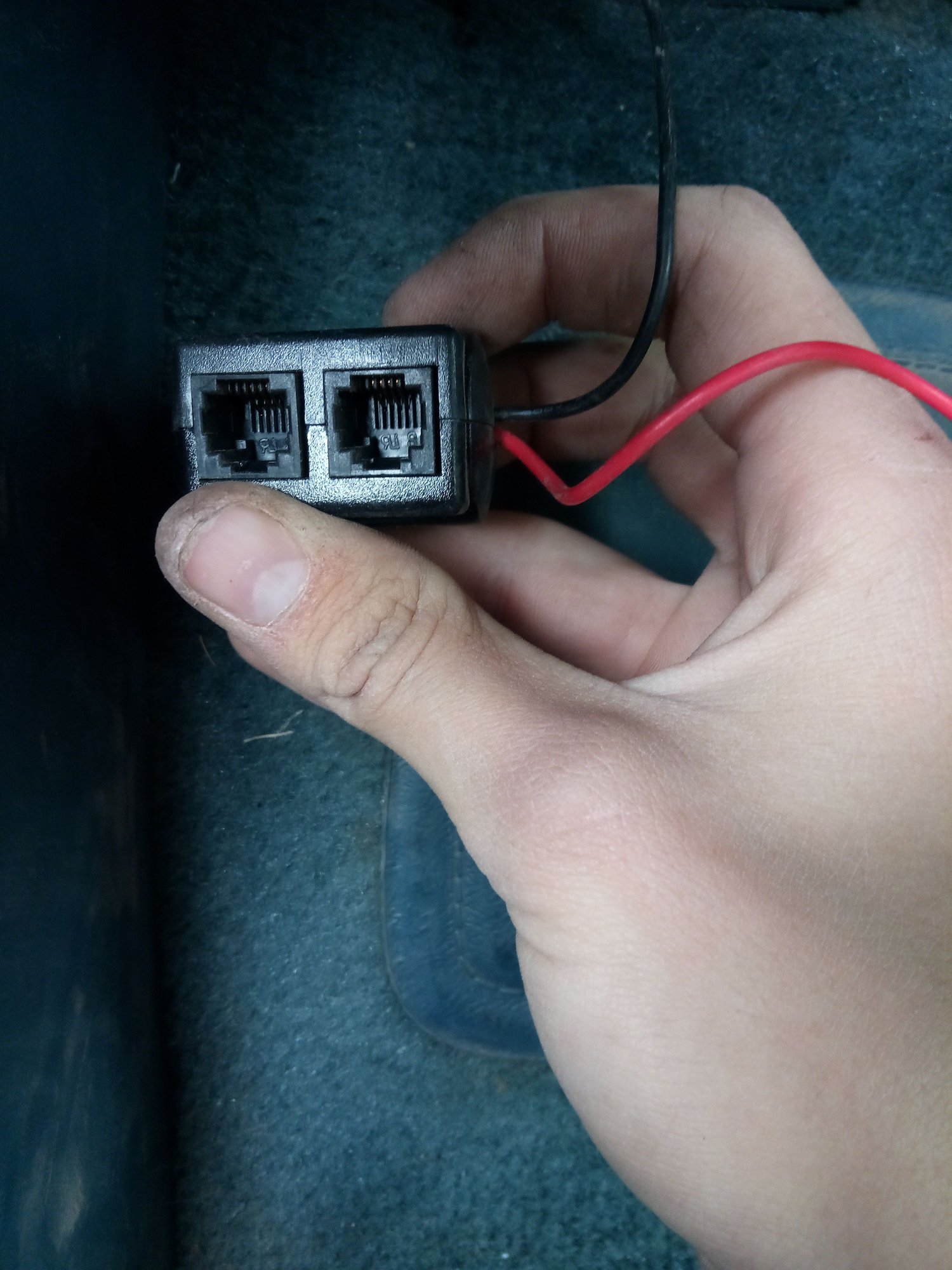

Default What is this??
There were some telephone style wires connected. Neither were connected to anything. It also had a switch run to power it
