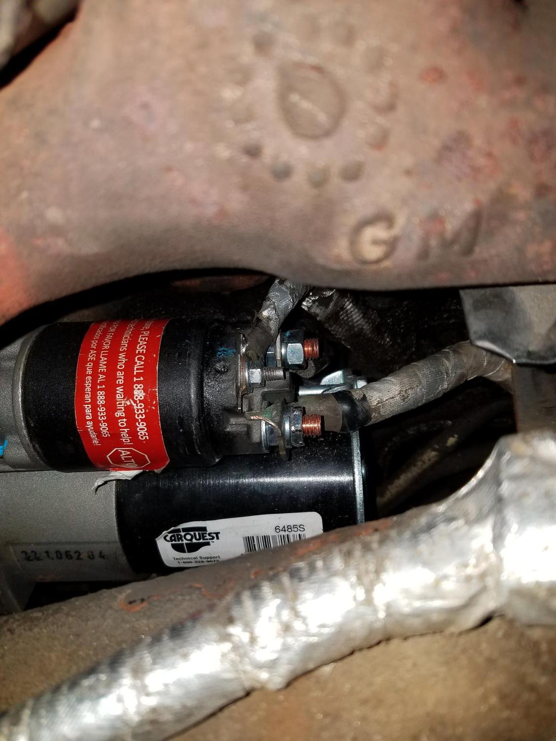

Dumb mistake. Why would they put those two "alignment" tab so close together. Running at 5 amp draw and charging at 14.73 volts. Key off 1.6 amps. Sleeping .25 amps.

What tabs?
Old Apr 4, 2022 | 07:10 PM
  #53
Karl S's Avatar
Joined: Mar 2022
Posts: 30
Karl S is on a distinguished road
On the two cable to the starter there is on tab each that go into little slots in the bake light part of the solenoid.
Old Apr 4, 2022 | 07:11 PM
  #54
GeorgeLG's Avatar
Posts: 4,659
From: Florida
Got it. Sounds like your fixed?
