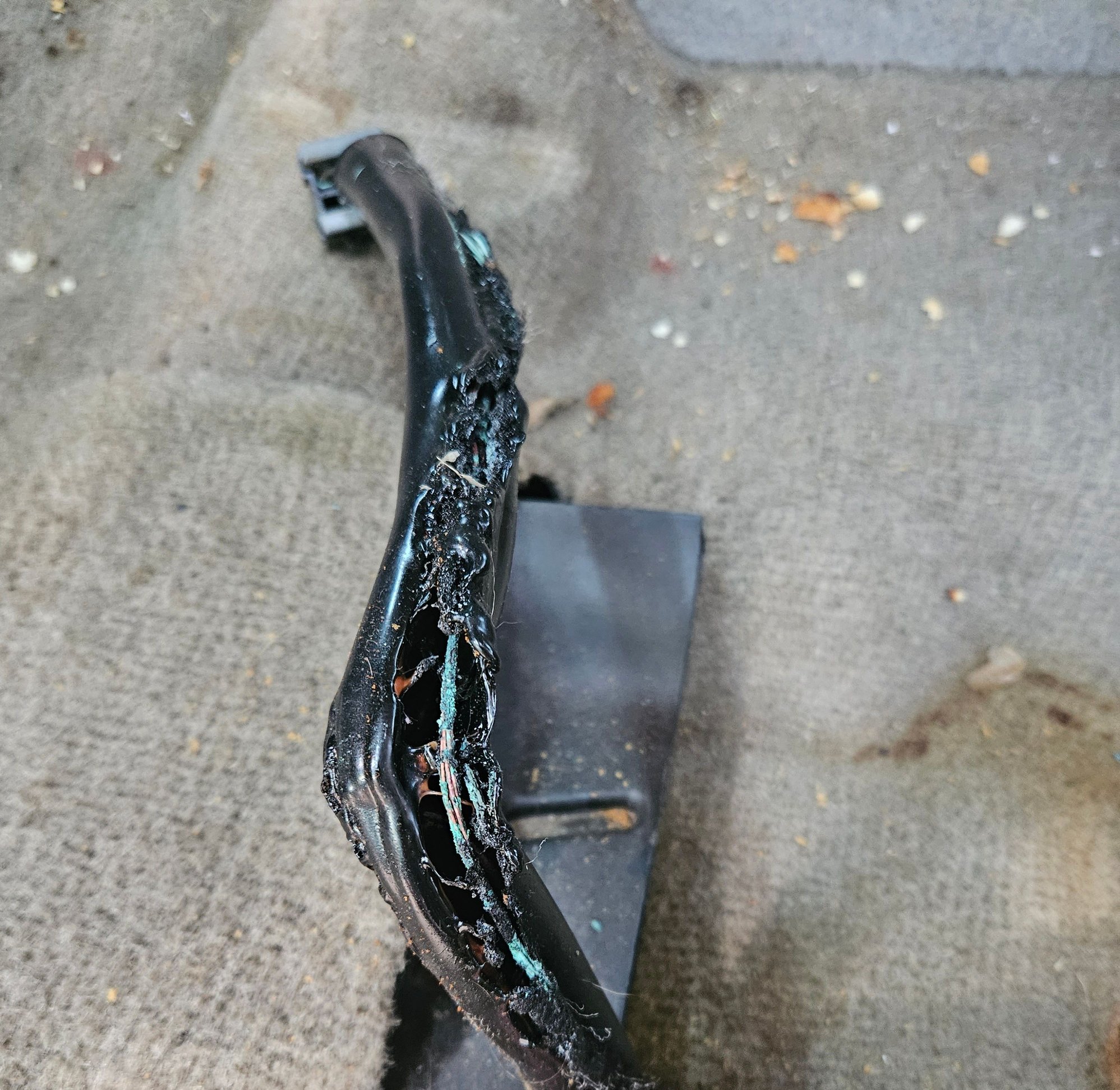

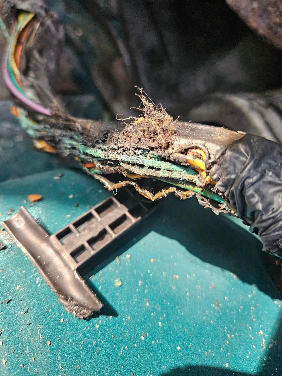

UPDATE! I found the culprit. The drivers power seat harness has shorted, and melted pretty badly. Gonna spend the weekend scouring junkyards to see if I can find one.
If anyone has a parts truck that had power seats, and would be willing to chop the harness, please let me know!

Nice find! Another option is to splice new wires in across the puckered up section but in order to do it properly you need to solder and shrink wrap. Let me know if you’d like some pointers on how to do that and I’ll be glad to help. George
