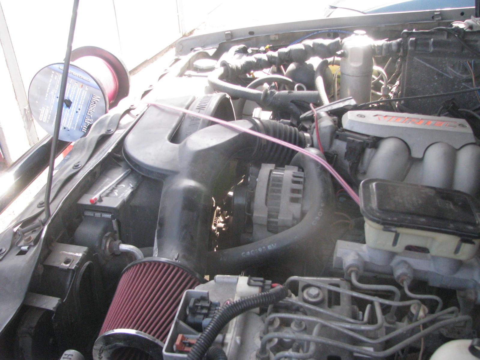

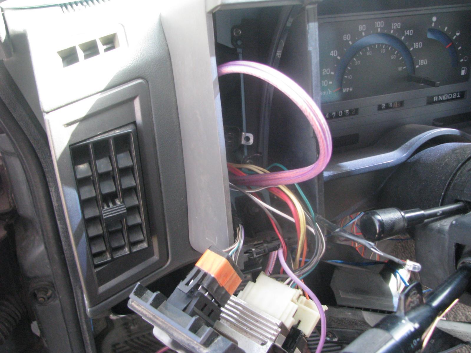

In my 93 2 door jimmy the was inside and ran out, thanks to manitobas "imoblizer" stopped my truck from running so i had to re wire my fuel pump.. worked better after but i know i had to change a relay to get it to start working? a toggle and some speaker wire never hurt no one though :P

I live in manitoba to and that immobilzer put my 93 gmc jimmy 2 door to its rest, wouldnt turn it on, so i did the exact samething i just rewired it to a toggle to, it was alot easier then i though too. Tested it on a battery to make sure it was good cause i had just put it in about a month or 2 before it stopped working
