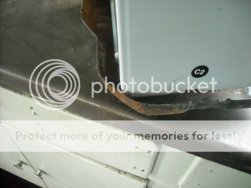

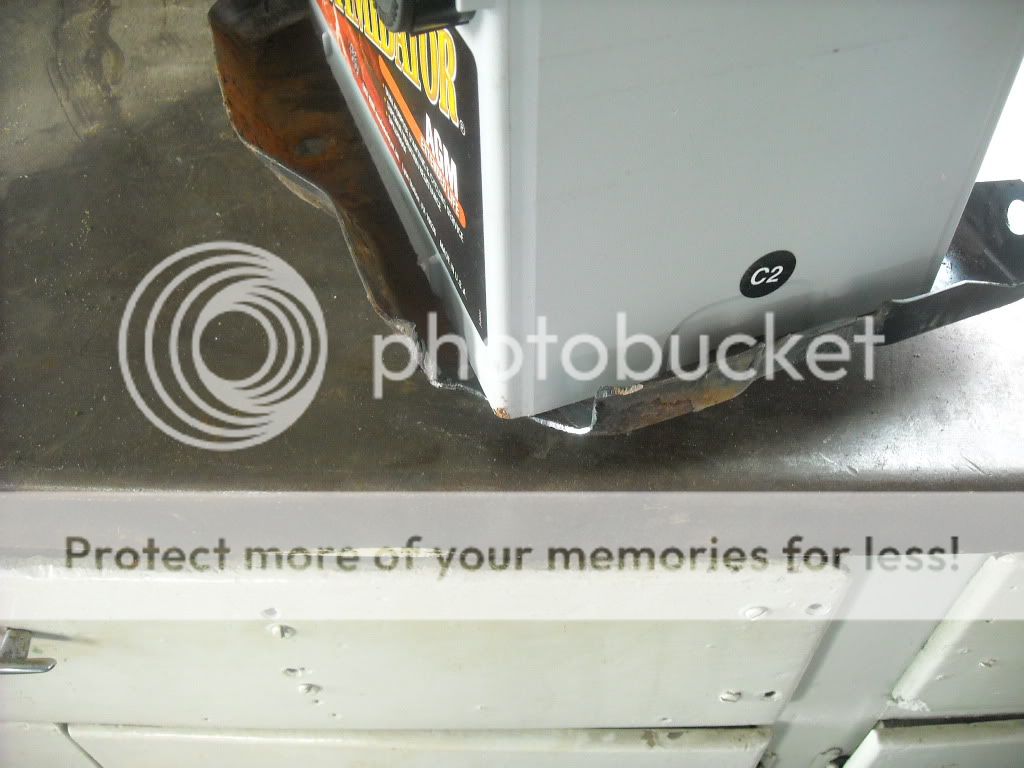

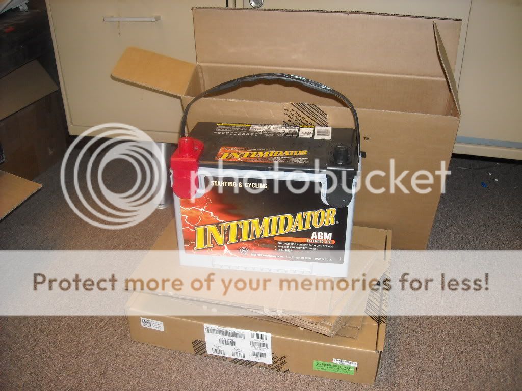

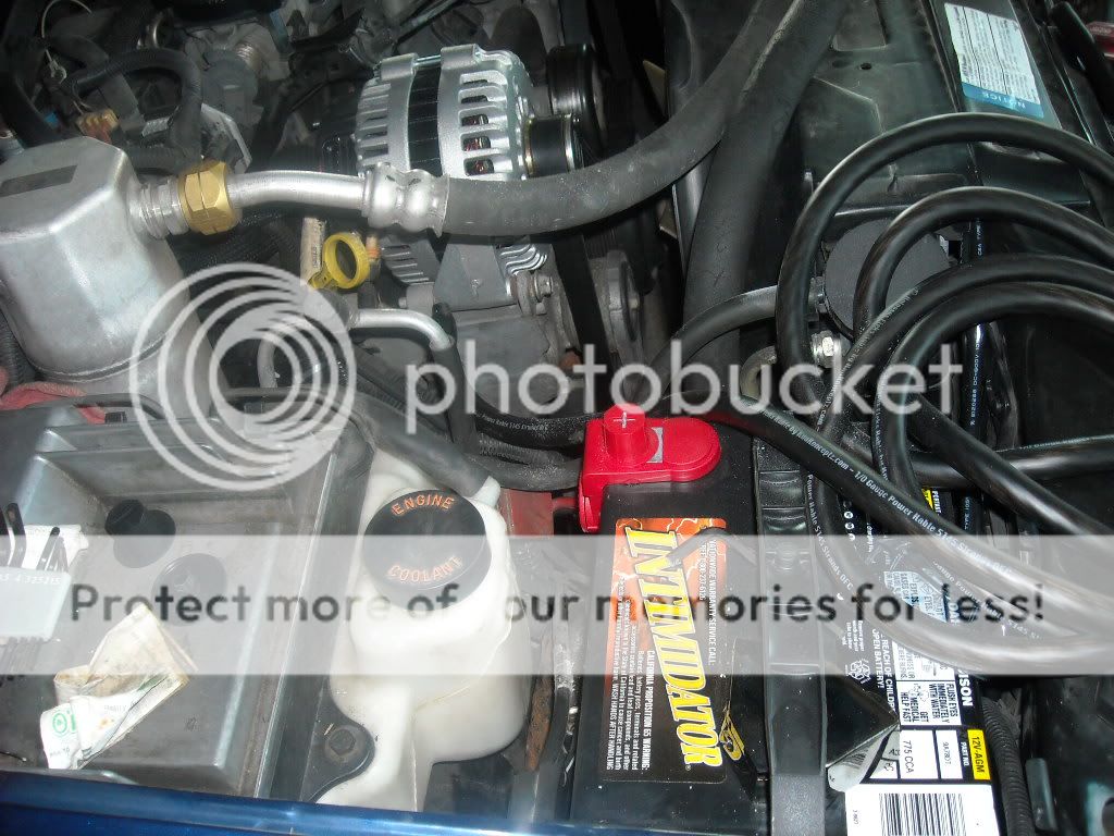

I have a 34/78 Deka Intimidator in my '01 Jimmy. I had to grind the tray a little to clear the corner of the battery and I have to take the cap off the radiator to remove/install the battery, but otherwise it fits like a tight glove.
Here's a couple of pictures of the modifications I had to make.
Here's a shot of the battery itself.
Here's a shot of the corner that needed modified.
Here it is after modification.
Finally here it is tucked down in the truck.
So yeah, as the others have stated, if you're willing to modify then you can fit just about anything anywhere. As for the batteries, not much to modify if you even have to.
