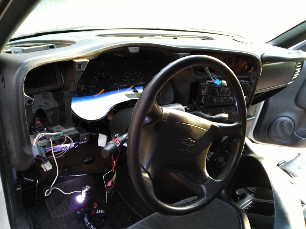

My problem: I'd replace the heater core in my 98 Blazer, and yes, taking out the dash was a PITA. But it worked OK. When assembly everything my cluster gauges dont work, only the volt and oil pressure gauges, check engine light works, and turn signals, but nothing else. And the radio dont work either, only the lights in the panel, and a/c also dont work, only light in the panel. When turning on the headlights, only the parking lights work. I checked the big connector inside the glove box,other connectors and everything looks fine.
One thing that occured: When connecting the negative terminal to the battery, the juction box started to make clicky sounds (like relay sounds) and the ignition coil give some spark. Checked the fuses (under the hood and inside) and seems to be all good.

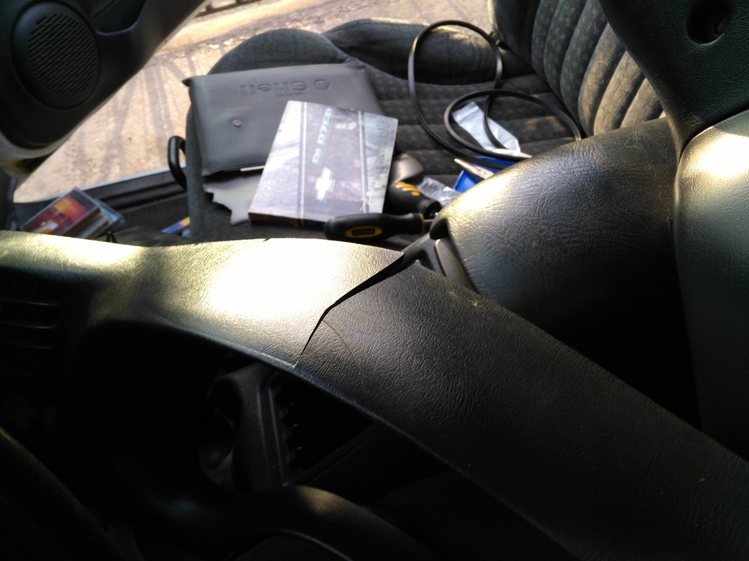

And I broke it. You wouldn't believe the amount of curses and F words I throw. But It gives me the opportunity to reinforce it with fiber glass. My next proyect.

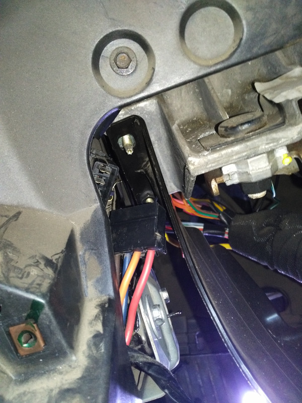

And I find the guilty one... was a unconnected wire tap. This one comes from the fuse box inside the dash board (driver's side) and was a PITA to try to reconnect, I have to take out the cluster again. I was afraid I had to take the dash panel out again.
